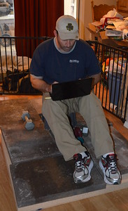

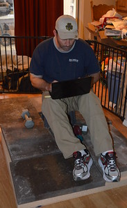

    How flat is your dining room floor? That was the flattest surface I could find when I built mine so I did it there and used myself and some landscape pavers as a weight while the glue dried. In the end, I had about a 0.5 mm crown over the 1500mm length.
