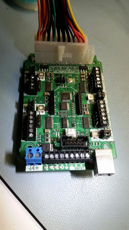

  20. Whodare
    Whodare New
    Jun 29, 2014
    Digger, I have a bunch of older 430 Watt AT PSU that I would like to use that have 20 pin connectors. The 12V rail on this PSU has 20A. I can't use the plug to connect to the board but if I cut all the wires and bundle all the yellow wires and black wires and connect to the 2 post side of the board (Opposite 24 pin connector) for 12V in (20A) that should work. I know i have to add a resistor to one of the red 5V wires to fool the PSU into thinking it has a load plus I have to isolate the Blue wire as the power switch. All other wires can be cut short and stowed off to the side. Can you see any other challenges I should look out for?
  21. Spark Concepts
    Spark Concepts Journeyman
    Dec 17, 2013
    131
    107
    Whodare,
    don't cut it yet. The older style 20 pin plugs should fit if you insert like this .. 20161213_075945.jpg
    Let me know if you have any questions.
    Thanks,
    Mike
