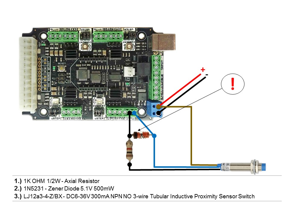

    Don't connect the the BROWN Wire to the + Terminal. This is probably at +24V and could damage the xPro board if the zener diode fails (on 24V its running at 576mW which is too high a current for the zener shown) . Connect the brown wire to the +5 volts connection close by and then you shouldn't need any additional components. **EDIT NOTE** there is just one catch though thinking about it, I believe the v3 board has new buffered inputs for the limit switches so you may need a pull up resistor between the black and brown wires (+5v and signal), your 1k will do nicely for this if it is required. (This is for the open collector, NPN version of the sensor which is the BLUE tip I believe).

    Hi Jim,
    Please tell me you have a real datasheet for these that you could share! We have been looking everywhere and cannot find anything on the internal workings of the switch. The data we found has a input voltage rating of 6-36VDC, so using the 5V for power might work perfectly fine, or might work sometimes, or might not work at all. If it does work on 5V - this would be optimal, there is a 10K pull-up to 5V on the limit pins. If they don't work reliably on 5V, then we need to consider both possibilities - the sensors being open collector, and the sensors being push-pull (at least until we have one in hand test). The circuit suggested above is assuming a push-pull (but should work for both) and gives you the following states (un-triggered and triggered).
    Here the 1K resistor is on the switch side (24VDC) of the zener limiting current through the zener. However, should the zener fails (shorts) this resistor will dissipate 576mW so perhaps a 1W resistor would be best (but at that point the zener is already dead).
    Life would be so much simpler if these are open collector units as they would give the following states (un-triggered and triggered)
    These would require no additional hardware. I'm pretty sure these are open collector units, but without testing them, suggesting the latter wiring option could cause a lot of smoke to be released...
    Thanks,
    Mike

    Hi Mike,
    Like you I have searched everywhere for a data sheet without success, sorry I have drawn a blank too!
    Checking around you are quite correct, most adverts showing the sensor seem to indicate the working voltage between 6 and 35 volts. (The information I used initially had both 5v to 36v and 6v to 40v in the same advert which I thought was strange at the time).
    I still worry though, about the sensor failing and pulling the switch line high to 24v letting the little blue Genie escape from first the zener and then the xPRO. Perhaps another way with a bit more protection could be to use a small signal diode to block any voltage getting into the the xPro’s circuits. e.g.

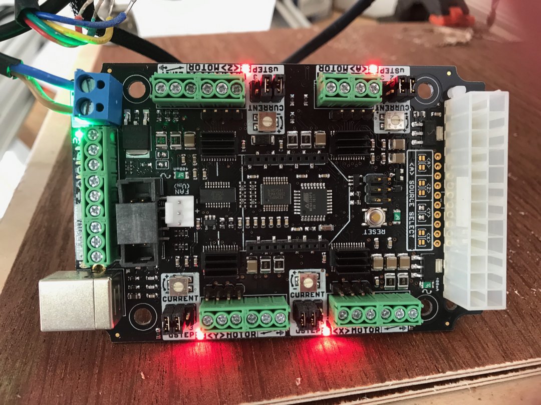

    Hi can anyone tell me what is happening hear? with the red lights .Thanks Richard

    Yes it does, there is a guide on the JTech website on how to use one of their lasers with the xPro.
    The leds are to indicate the motors are getting power.

    The led's never lit before,when the motors are connected and the lights are on they just buzz and stay locked, the grbl sends the codes but nothing happens, everything has worked fine before with no red lights
    I hav been trying to resolve a problem I have had from the onset,a discrepancy between the sketchup drawing dimensions and the machine cut with varies between 2.5mm and 3+ mm I was in the process of re entertaining the settings in the grbl,then running a test cut and it all locked up. I have checked and rechecked the settings the leds will not go out and the motors stay locked.
    Sorry for the long description but I am lost of what to do.
