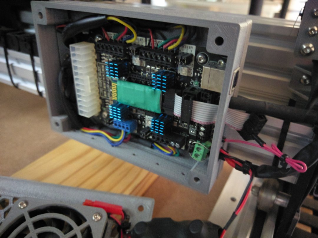

    stargeezer Journeyman
    Feb 20, 2015
    328
    117
    Hello. Could you share the file or llink for your cool xpro case? I like that jewel!!!
  28. Giarc
    3,062
    1,713
    Hey Stargeezer, the person that posted that picture has not been on her for the last 12 weeks. So, not sure how soon he will get back to you. This is similar if you want to check it out. Box xPro V3 by jopoma
