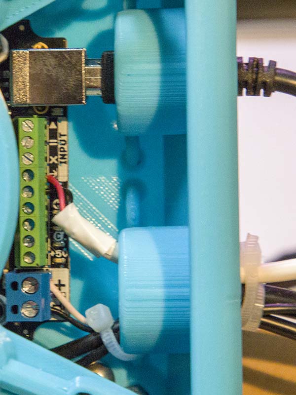

    Hi mike
    Sorry I don’t have a wiring diagram for the spindle motor, it was just a cheap spindle bought on eBay
    I do have a serious question/concern though. I left my machine running an 8 hour cut and came back to it to find the USB port had moved on the board, it looks like there is a serious problem with heat. M running a 24 volt system cooling fans are installed everywhere and as you can see from the photos I installed the xpro upside down to avoid stress on the port . I just wish I’d taken the photos before I tried to secure the port with epoxy.
    My problem now is it cost a fortune to have this shipped from the states so I’m now waiting for @ooznest to get stock or think about maybe getting a blue bee module
    Rob

    @Rob Atha - probably not heat on that one, we did a lot of thermal testing on the V4 (72hr full current runs with no active cooling). The heat is generated from the motor drivers but they will go into thermal shutdown at 356 degrees farenheit and only come back on when they cool to operating temperature. For reference the usb plug requires a 700 degree iron for about 10 seconds to reflow. Hopefully gives you some peace of mind.
    However, interesting failure that I would like the techs to look at - how about a trade? Email me at mike @spark-concepts.com if you want to (take out the space)
