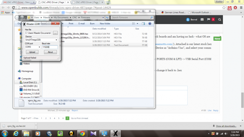

    Mike, thanks for the reply, I have tried the above steps, no success, the Xloader just keeps saying "uploading", but nothing happens:

    Have you tried using a different computer (with a known working COM port) ? If the controller still does not respond, it's probably at fault (or the cable if you used the same cable).
    Or, try connecting something else (known to be working) to that COM port ? If it still works, it is not the port (neither the cable if you used the same one).
    Check the cable as it is often the last thing we check when it should be the first.
    These are often the easiest and quickest tests, but the last to be done in frustration.

    So, tried different hardware at the various USB ports (external HD), no problems.... same issue. I have even tried different USB cables (went to my neighbor and got one from his USB HD). no success....
    Don't know what to do anymore, any help appreciated ...... I have tried that Xloader again like recommended by Mike, same story, it hangs up....

    After testing all and every single setting, different USB cables, different computers, hrs of Baud rate changing, software de-install and re-install, trying to upload the provided firmware......NOTHING....
    Still the same issue.
    Can someone please send me details on how to return the board or whom to contact? I have read some good things about the board, but stumbled across some posts where users have similar / identical problems. If the board would have worked before I, at least, would have had a starting point, but no, it did not. If it was tested before shipped, like mentioned by Mike, then i assume it was damaged during transport, although, the package wasn't badly damaged. I don't know if the cold, when it was shipped, could have damaged it.
    Question: would TinyG or another board / controller.... be more recommended or did I juts got a bad example of the Xpro board ?
    Nevertheless, I want to return and not waste anymore time with it. I am out of ideas (perhaps I could try changing the baud rate at midnight with full moon and when standing on one leg...etc......)

    Where did you buy the xPRO? Here on OpenBuilds? If so contact the Part Store as there isn't any RMA information on this link: http://openbuildspartstore.com/shipping-returns/ .
    Seems like something went wrong with the firmware or it was just a dud CPU. One thing that doesn't help is to try to get help on defective parts trough this forum if you bought it here.
    Personally I like the TinyG better as it's in a further development state than the xPRO, it also has a less compact, less clouded, layout, less focused on cheap builds with an ATX PSU (I would not use 12v). The support group , as in customers that are using it, is also much larger.

    Bernd - Sorry to hear you are still having issues - if you could send us an email at [email protected] we can start an RMA for you. If we can get some information from you tonight we can have a replacement in the mail tomorrow morning.

    After I have received the replacement board, I have installed it last weekend and, after initial adjustments, was able to do some test runs.
    Regarding the controller board, everything runs fine now. I did, however, had some initial trouble with the start-up, which, turned out, was caused by the software(Grbl Controller).
