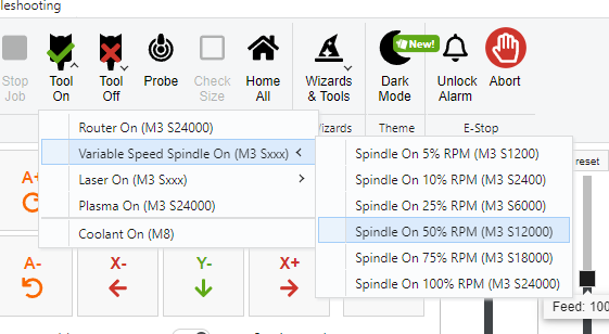

  18. Peter Van Der Walt
    15,190
    4,346
    No, just explaing the relation between 0-10v scale and what spindle should do (and why $31 should be 0, to let the VFD handle the minimum startup speed instead, rather than offsetting the scale)
    Lets confirm the BlackBox side first:
    Disconnect VFD, put multimeter on 0-10v port like when you did calibration
    Then use CONTROL > Tool On menu:
    At 5% you should see 10v * 5% = +- 0.5V
    At 10% around 1V
    At 50% around 5V
    At 100% it should be around 10V
    At 0% it won't quite go down to 0, it always have a couple millivolt present (that kicks on a VFD if Min Freq is not working, but with Min Freq set up it will not kick on the VFD)
    Some variance expected, (purely analog PWM to Voltage converter onboard) but just to confirm the Grbl Settings are correct, you should see that.
    If that does happen, then the BlackBox/Grbl side is correct
    Clicking is the onboard relays (Same tool on command for spindle, is used for Plasma etc - so you have nothing wired to the relays, they will still click because other applications use them - its a good audible confirmation that Tool Enable was triggered, but not used with standard VFD wiring (0-10v signal only, VFD uses its intelligence to decide what to do based on the voltage on the wire as descibed in 0V=0RPM, +-3.3V=7200RPM=turnon, 10V=24000RPM)
    I'd prefer we get Min Freq working right on the VFD - you can wire the Relays into the mix, but it sort of complicates it, should just be a matter of the correct parameters and then its also protected from accidental commands with too low RPM - more the "right" way to do it.
  19. Tony Magrini
    Oct 16, 2024
    17
    Ok so at 100% it was stable at 10v .... at 5% It bounced from 0 to 1 which seems normal ....At 10% it stayed on 0....at 50% it was all over the place going from 0-9 bouncing around never leveled out. At 100% tested again it held on 10v
  20. Peter Van Der Walt
    15,190
    4,346
    And thats with VFD disconnected? Any other Grbl Settings changed from defaults (like for example the PWM freq etc?)
    Using a good clean power supply like our recommended Meanwell?
    Your xPRO issues was VFD related too? If so maybe faulty VFD damaging the controllers (2 in a row, with a shared accesory is suspect)

    Stock standard is a good start (5000) or could try 1000. Profiles doesnt fix all values, so question is more what else was changed manually. If its a lot, EEPROM reset (button on Grbl Settings tab) followed by loading machine profile should help get it all back to defaults
    Yes:
    50% should be +-5V. Like within a couple percent. Not 0-9v.
    That might be some abnormal settings, or the VFD caused damage to the 0-10v output.
