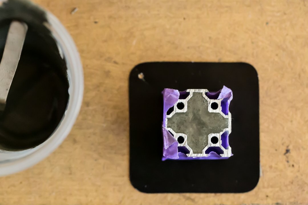

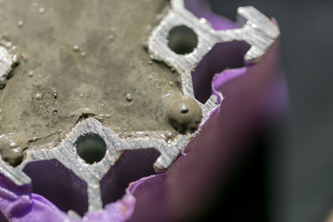

    Don't really know Evan, I just know there is some kind of reaction going on and by the way I followed your suggestion of trying Moroso Engine Block Filler, not hardblok, so hardblok may be a totally different kettle of fish.
    Here you go @Joe Santarsiero some pics of the process.
    Mixing and pouring. Morose Engine Block Filler.
    Little mud volcano. You could still hear it crackling away after to had solidified.
    Not easy to sand, this was done on a benchtop belt sander (it wasn't happy). So I think I'ill try melting a candle in shallow metal tray to seal the bottom and not totally fill.

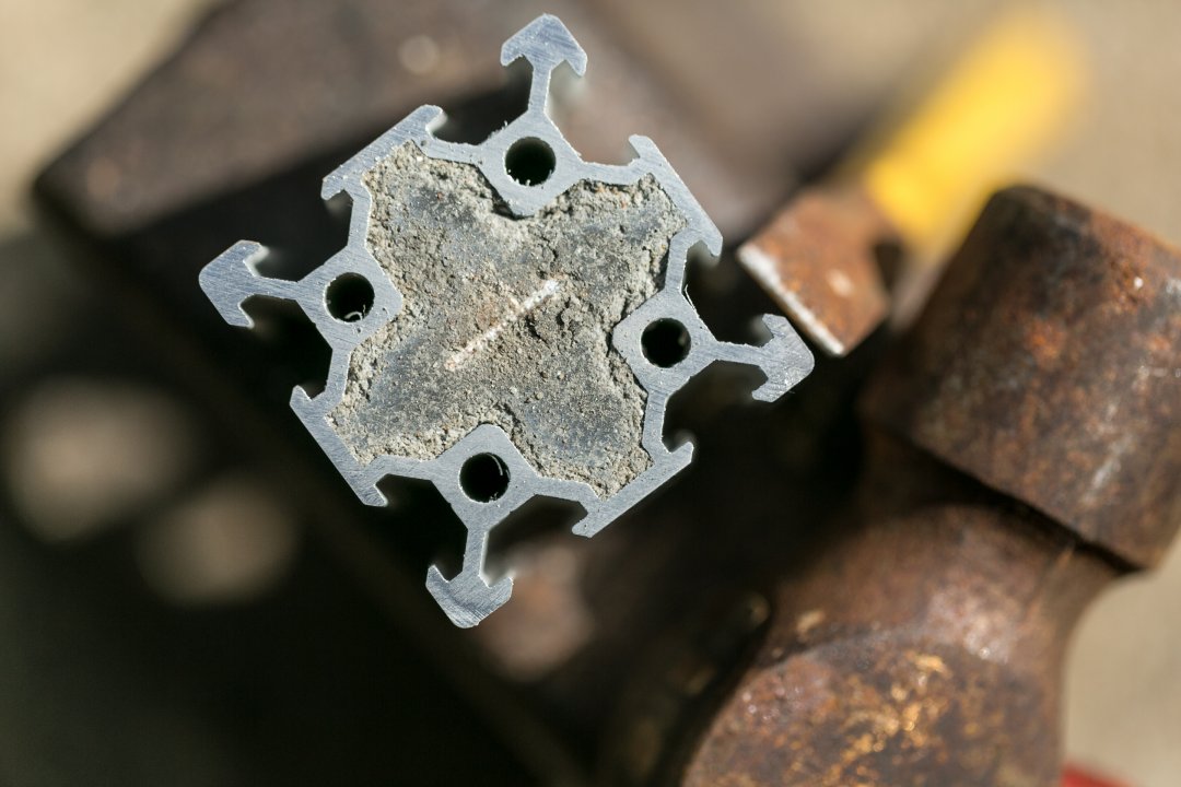

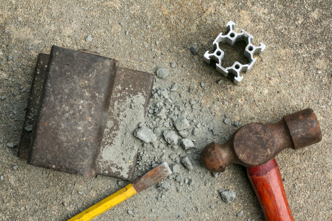

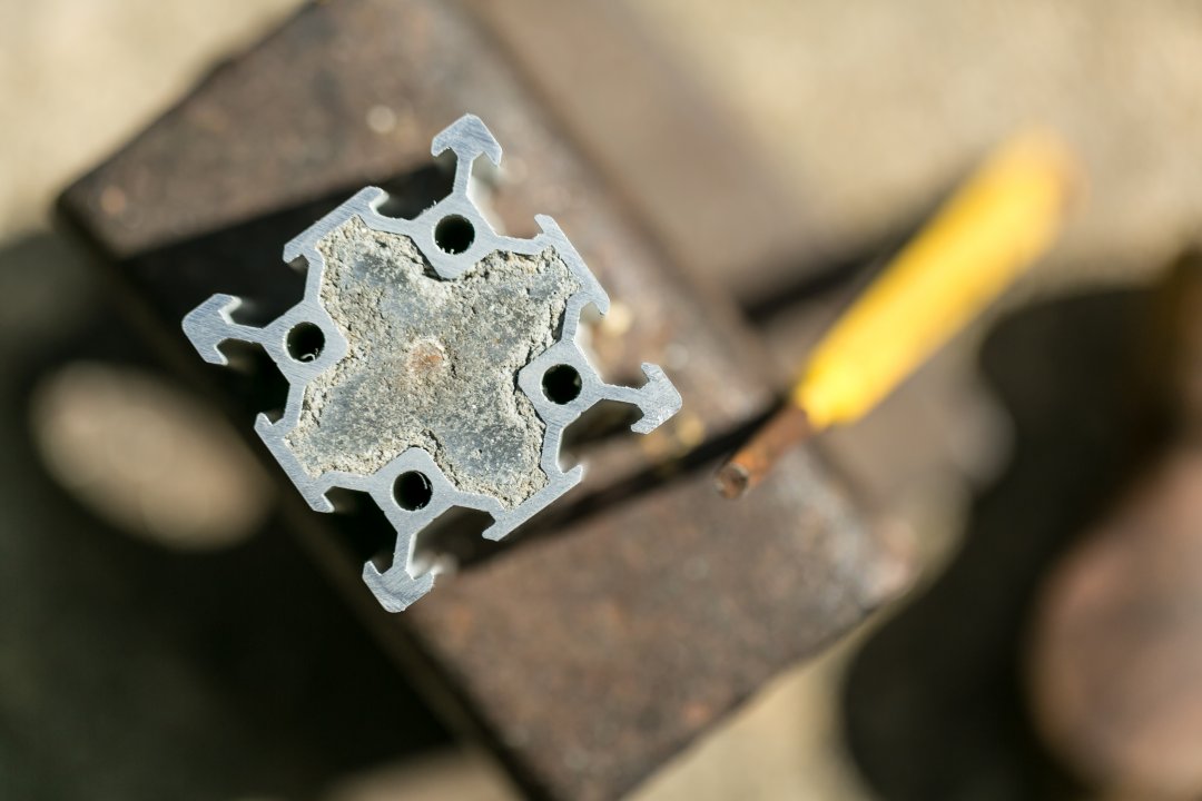

    One good solid smack with a ball hammer and a flat punch on a section of railway line on concrete.
    Followed by one solid smack with a small cold chisel.

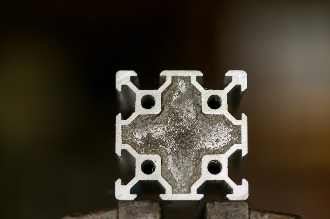

    Getting there!! From my experience, its hardness is somewhere between marble and concrete.

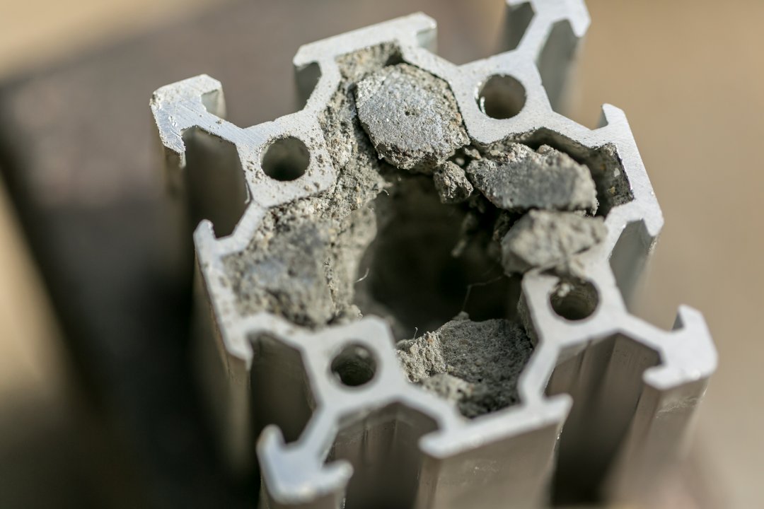

    Cleaned out. Another mess to clean up.
    What it looks like on the inside after knocking it out..

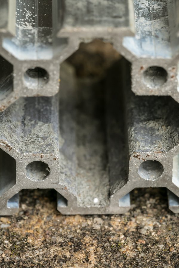

    Well isn't that a wee bit corrosive... :eek::eek::eek:
  4. Moag
    Moag Veteran
    Mar 16, 2016
    183
    296
    Not as bad as it looks Rick, just giving it a bit of a clean with nylon brush and some white vinegar, most of what you see is the grout stuck to the aluminium. Give me a little while to take and process another picture.
    And here's the picture. It has a satiny feel compared to the smoothness on the outside, but certainly messes with the anodising.
