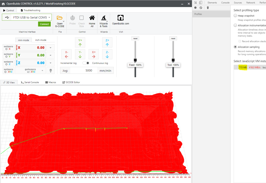

    Hey all,
    Ran a roughing job, did great.
    Went to load the finishing job, gcode loads:
    [ GCODE Parser ] GCODE File Loaded
    Go to run the jobL
    [ websocket ] Disconnected. OpenBuilds CONTROL probably quit or crashed
    Is there a size limit? Mine is a large file, 118MB, 4.6million lines I believe. Is this beyond the capabilities of tis software? Have had many smaller jobs go great, largest prior was some 2.1million lines of gcode.
    Any help would be greatly appreciated... got a beautiful piece of walnut that needs finishing lol.
    Thanks!

    Disable 3D viewer from Troubleshooting tab. The 3D view uses most memory, as it renders the segments, simulation data, and even time/checksize calculations. With 3D viewer disabled only the gcode file itself (118mb) is in RAM. When you click play its sent to the backend (another 118mb) - so not a lot at all.
    Try after a fresh reboot, with 3D viewer disabled, before loading a file.

    The in progress changes to the 3D viewer looks great
    Parsed your big file, rendered preview, only using 715MB of Heap space :) - was closer to 4GB before the changes to the code.
    I figured out your error message's cause - wasn't 3D view related after all :)
    Code:
    [20:57:22] [ websocket ] Disconnected. OpenBuilds CONTROL probably quit or crashed
    We can't send that much data between the frontend and backend in a single call :) - it takes too long, the Websocket server times out. So let me wrap up the 3D viewer changes (affects the simulator - got to catch it up to the new smaller data structures of the new lighter 3D view) and then I'll work on the transfer issue :)

    Fixed, you can download the beta of v1.0.272 from: AppVeyor
    Note, beta, report any funny business please - there were quite a lot of changes :) (more changes = more chances to make mistakes)
    If you want to roll back, official releases are here Releases · OpenBuilds/OpenBuilds-CONTROL
    - New 3D viewer: More lightweight smaller memory footprint, maybe renders a little faster, supports larger files, shows Progress percentage while rendering, smoother anti-aliased graphics looks better
    - Simulator changed to work with new 3D viewer data
    - Prevent large files from loading to Gcode Editor (gcode editor uses a lot more ram than we thought, now files >20mb is not loaded into the editor)
    - new RunJob method for large files (http post instead of websocket)
