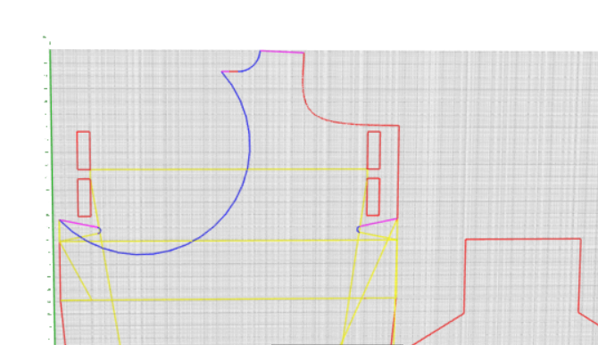

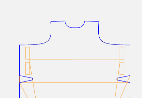

    I am getting some strange behavior for the open builds Control software. It is inverting one of my arcs and skipping an entire part of my cut. The .gcode behaves normally and as excepted in other software. Please help. Using an in house post processor, but I have had zero issues with it prior to this. Other arcs and lines are not affected by this in the same sketch either.
    OpenBuilds Control:
    NCViewer:
    #1 PIOPIO, Feb 16, 2022

    The error could possibly be isolated around line 13197: G3 X340.122 Y1914.37 R44.45 where the arc is created.

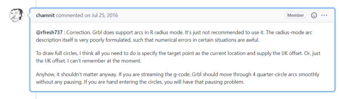

    If it fails to calculate the arc, the only reason is the numbers are off. We're just the symptom of an issue with the Post...
    Also, Grbl prefers IJK arcs, don't use the R format
    Note what Grbl's own developer says: "It's just not recommended". Change your post to use the better IJK format instead and all will be peachy

    agree with the 'dont use R format'...

    @Peter Van Der Walt - you do have to look at the OB display code. from about line 9170 in his file there is a long string of small motions without G1, many many lines before it gets to the 'faulty' G3, and that section does not display correctly until I add a G1 every few pages in my editor.

    His post should add the G1 after that M8 at 9167 though so the parser knows we are in a G1 block
