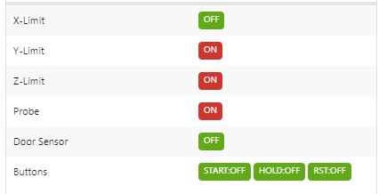

    Control software says probe is turned on and X-limit is turned off but X-limit is connected. black box.JPG
    Builder Resident Builder
    15,699
    4,510
    Seeing as these two are on opposite ends of the controller, sure you didnt just plug in starting from the wrong side?
    As in instead of X/Y/Z/PROBE you started at PROBE/Z/Y and left X open?

    It's not "being connected" that shows as ON, its when the switch is closed/triggered/axis is hitting the switch to indicate end of travel - that's when it light up. If it lights up as ON all the time, check your $5 setting (or change from NO to NC wiring, or NC to NO, depending on what you are doing / which switches you have
  4. Bill Jennings
    Feb 16, 2015
    I had everything connected right after downsloading usb files everything is right.
