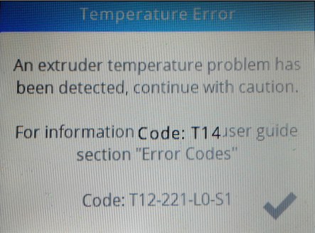

    Tom, Have you found a way to stop/Get Around this error? No matter what I print about 10 minutes in the print will stop with that error? It is making it impossible to use the printer. I'm using Hatchbox ABS Green on a Black ABS cube cartridge on the left side. I haven't tried to do anything to the nozzle. I Patched with 1.0. Any thoughts?
    EDIT
    I have been playing around with inserting and reinserting the nozzle and the print appears to have passed the usual point of failure. Will update if it fails again
    #283 Dan Kantrowitz, Feb 12, 2017
  14. Tom Dirriwachter
    Tom Dirriwachter Well-Known
    Aug 30, 2016
    297
    35
    The patch is of no concern, of course. There is a sensor in the print-head that is seriously sensitive to any sudden change in feedback. I suspect it is the temp sensor, but I do not understand how this is managed. However, I do know that excess restriction to the filament line, or any disturbance while printing will set this off. But I also had a printer do this to me when I forced air over the part using ABS. PLA was working fine, the room was warmish, and no matter what, ABS would fail after about 10 minutes where PLA worked fine. In that sense, it must be hyper sensitive in warmer environments. Never had this occur when the ambient was at laboratory temperatures.
    Check to see if you have any filament in the heater part of the print-head where the nozzle goes. You might need a flashlight.
