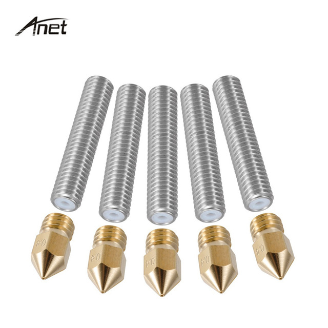

    Alright guys, I have an extruder mod to replace the proprietary nozzles.
    First, you need a M6 tap, a slightly smaller than M6 drill bit, M6 threaded 0.4mm nozzles, and M6 threaded throat tubes.
    First, remove the old nozzles.
    Next, drill straight down into your heating block.
    Then tap the top and bottom of the block with the M6 tap.
    Last, screw in your new nozzle and throat tube.
    I've made several prints with this setup now, and the quality is better than I've ever gotten.
    For what it's worth, i also upgraded the bowden tubes and fittings to reduce feeding issues.
