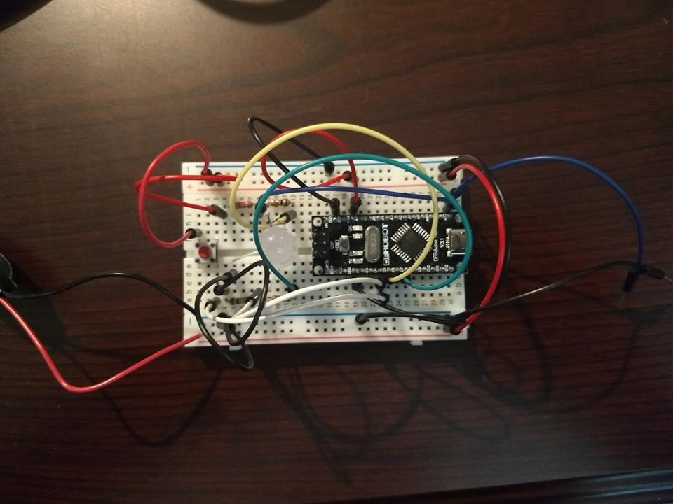

    Hey John,
    I have been trying to get a response from Tomuro. I have built the Arduino prototype and it worked wonderfully to reset my ekocycle cartridges. I have also hacked my firmware to no longer change the % of filament used. I have also convered my Ekocycle to a cube 3, but would like the Recube Pro for the arduino to allow me to reset the Ekocycle cartridges to ABS. I have donated to Tomuro as well. How long did it take for him to get back to you? Are you able to share the pro version with me?
    John
    #497 buddybu, Jul 23, 2018

  19. JT3D
    JT3D New
    Feb 20, 2018
    31
    Your breadboard is prettier than mine!
    I'm surprised that Tomuro has not responded - he was usually replied within a day or two when he was working on the Ekocycle part of the code. I think he may have been getting a bit tired of the project by then, though.
    At that time - last March - he was using eddress: tomuro at haxtom.com
    At this point, I would feel bad about sharing his code without his knowledge. Let's try to get in touch with him. I'll try sending a note.
    buddybu likes this.
  20. buddybu
    buddybu New
    Nov 15, 2016
    Thank you for your assistance. I understand that you wouldn't want to share his code. :)
    Thank you for the compliment about my breadboard, this was actually my very first project like this, and the first revision was actually very, very ugly and incorrect.
