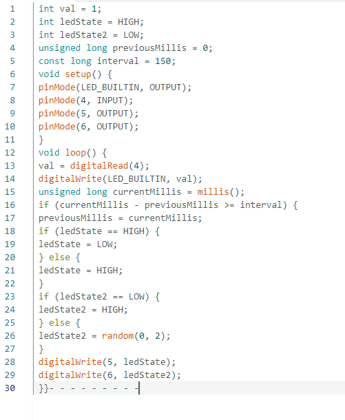

  7. 3Dprinting is the gout
    May 21, 2025
    is this the correct cod for the Arduino for HOW TO Building Tomuro's Circuit? upload_2025-5-23_16-59-37.png
  8. Tom Dirriwachter
    Tom Dirriwachter Well-Known
    Aug 30, 2016
    297
    34
    If it came from haxtom.com, yes. He only posted one free version.
