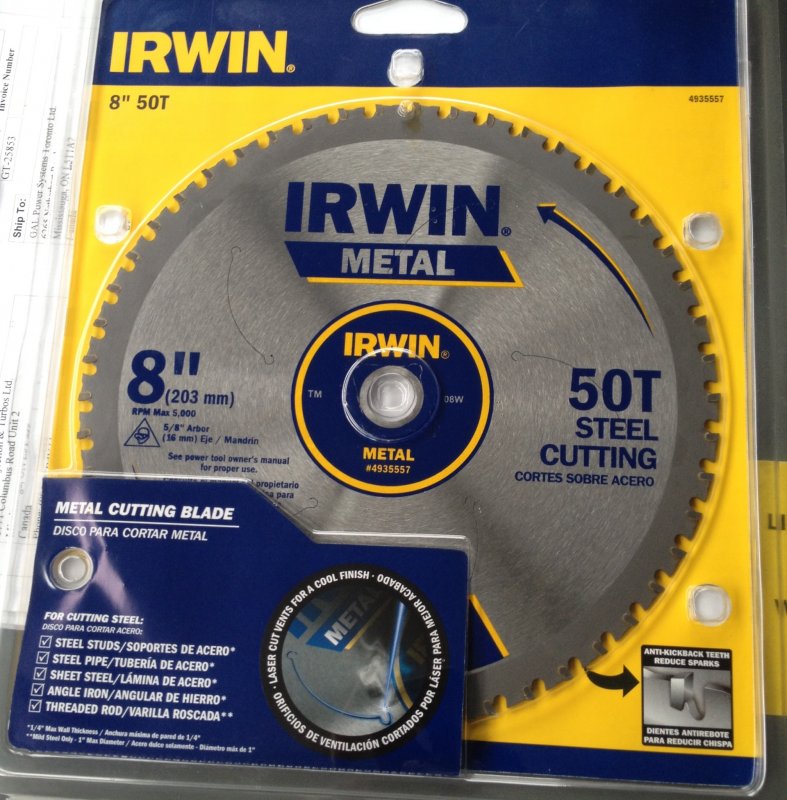

    Way cool! An 8" metal cutting blade that will fit my panel saw! I've been putting off attempting to cut aluminum with circular saws, but now I gotta get my courage up.

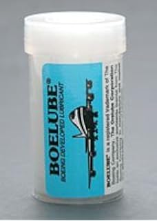

    For aerospace and alloy shipyards Boelube is probably the go to cutting lubricant a little dab on your blade works wonders they do a small Solid - 1.6 Oz. Push Tube which is just a few dollars and ideal for hobby use its great for cutting, drilling grinding and tapping aluminium I wouldn't be without a stick.
