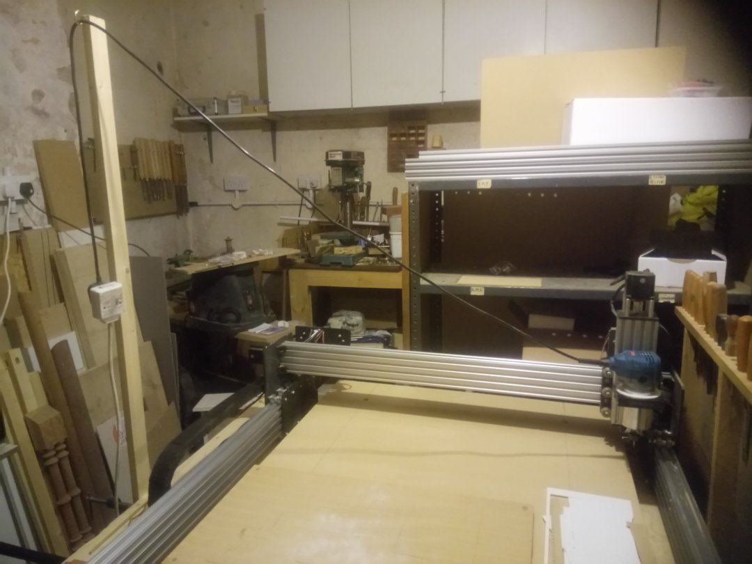

    I just routed my mains cable for the router above the machine - one day I'm going to arrange a more sophisticated support for it. :D:p:) The mains cables for my power supply are at the front of the machine, and the controller at the back.

  14. sharmstr
    2,059
    1,448
    I basically did the same thing "just to see if it would work" about 8 months ago. I finally swapped out the scrap piece of wood with some 20x20 extrusion today.

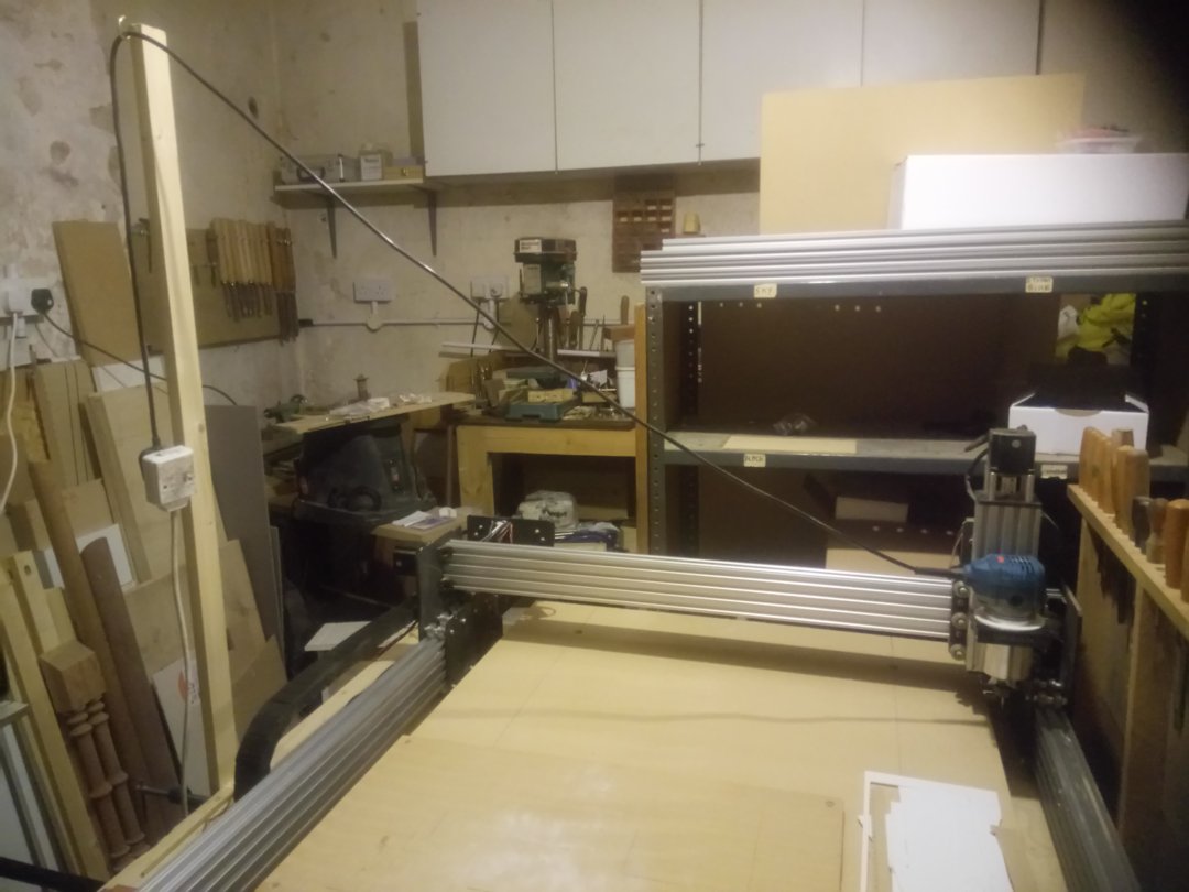

  16. GrayUK
    Error in exactly the same place doesn't sound like EMI. Probably not mechanical per se, but sounds like an event happening in that position.
    i.e. Cable bend causing an EMI event at that point, a mechanical stress point, etc. An error in the Code. :rolleyes:

  17. Alex Chambers
    2,780
    1,361
    Can't see how it could be the code if it works sometimes, but if you post your G code here I'll have a look at it.
    Looking at the cut that went wrong I can't think of a mechanical cause either - that would usually result in the machine trying to follow the correct path, but offset from where it should be.
    Let us know how you get on when you have extracted your power lead from the drag chain.
    Alex. :confused:
