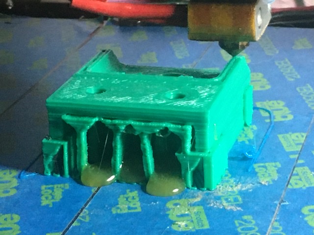

    2FD5A7AC-0AEC-423A-81E3-AD0B233DAD35.jpeg Hi Neil, just having a bit of trouble printing the lead screw brackets. As you can see in the photo, my support columns need support!! When they start to get thick at the top, the drag by the filament coming out of the nozzle pushes them over because there is not enough support at the base of the columns. I had to pause the print and drizzle hot glue around the base to support them. Are there any slicer settings to help this. Just as well I’m using maskin tape!

    Hi Neil --
    Try printing them in this orientation. It will put the rough edge where you won't care, and the detail of important features will be good:

    What slicer and support settings are you using?

    I use Simplify3D. For this part it's 60 percent fill, .16mm layer, PLA. Support is turned on. Of course there are a LOT more settings, which ones are you interested in?

    It was the other Neil I was asking since he has some problems which I had never encountered when I use support.
