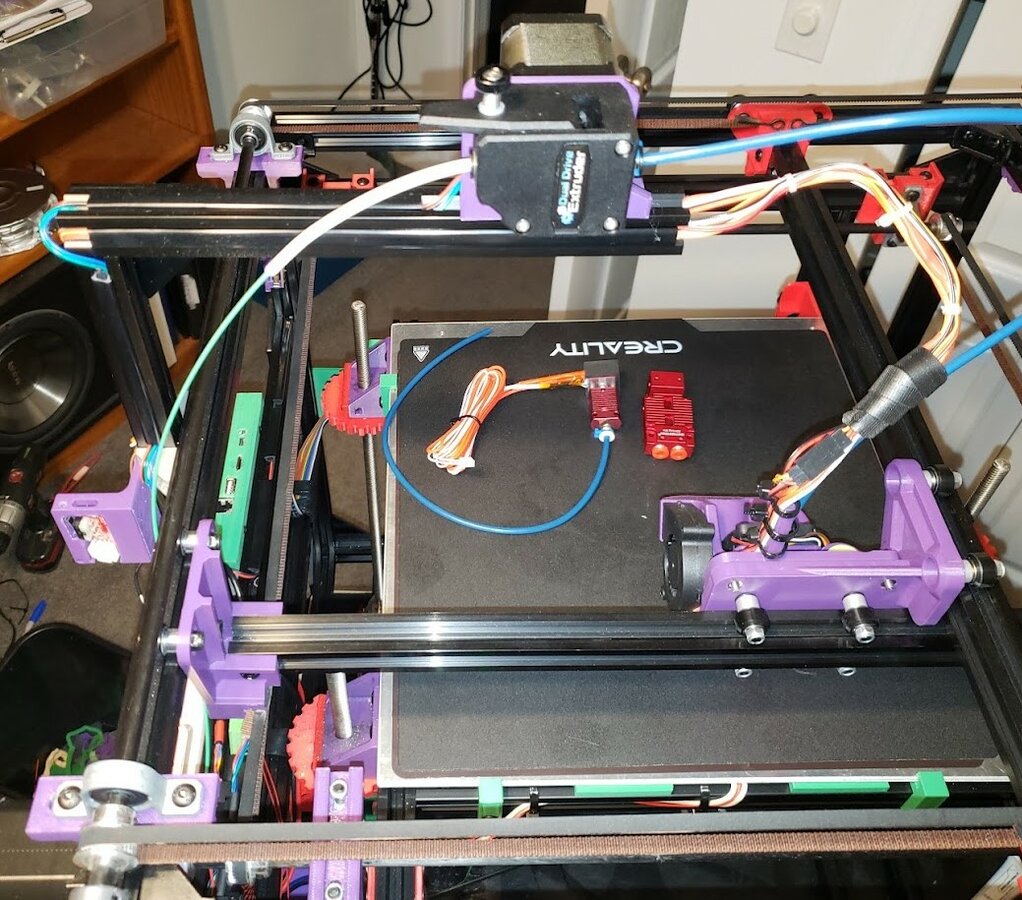

    Just to feed back on my experience with adding a dual extruder with a single nozzle hotend to my Dash-X.

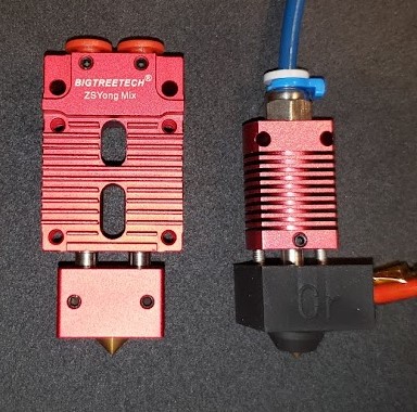

    The BIGTREETECH 2 In 1 Out Hotend Extruder Dual Color 1.75MM 40W - 24V I purchased was disappointing. It fitted the Dash-X after the modification of the mount spacing which was easy enough once I got long enough screws, but had to hollow out the fan shroud to fit the extra width. It works, sort of, but the problem is that to change colour, you have to retract the first filament almost completely out of the hot end to allow the 2nd colour filament to be fed in. This jambs in 4 out of 10 cases due to, I guess either the filament stringing, and the end of the filament sometimes swelling slightly and jamming, or the filament getting jammed on the internals of the 'Y' piece. Either way, it just became too frustrating in the end after spending weeks on different retraction settings & temperatures etc, but nothing seems to be able to cure what I feel is a flawed design. Doing a bit more digging for a solution, I found a number of people who reported similar findings, so I don't feel too embarrassed about not succeeding.
    I have ordered a different mixing hotend from the same manufacturer which does not require the retraction as the mix is in the nozzle so a minimum amount of retraction required. Not as convenient to fit to my Dash-X as it looks like it may need a redesign of the mount but will know better when it arrives. I opted to try this out next - BIGTREETECH 2-IN-1-OUT Mixed Color Hotend Bowden Extruder for Titan Bulldog 3D Printer Parts J-head Hotend 1.75mm Filament - Red 24V
    I will feedback once I receive it and I have it working.

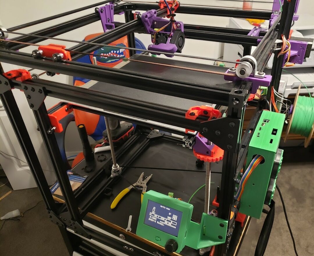

    I finally got mine up and running a few weeks ago. I won't admit how much time I spent trying to get the Z direction correct....the bed kept moving down when I hit the Z up arrow button :rolleyes: . About the only mod was positioning the extruder over the center of the bed.
    I've almost got it dialed in enough to allow my wife to use it. I just have to figure out how to tell Marlin to allow the print cooler fan to come on automatically.
    I gave up on the dual color extruder after discovering it was quite a bit larger than the original and would require quite few mods that are beyond my rudimentary 3D modelling skills. It is the same one Markal is now waiting on. I'll be happy to test print the parts if someone can generate the files.

    I will happily share my files for the Dual hot end once I have got it working. I hope it will arrive before the end of April.
    As soon as I have anything useable, I will let you know.

    Very VERY nice looking build! So happy you've got it running, I'm curious how good the print quality is. Perhaps you could post a photo or two of (pick a part)?
    Congrats!
    Neil
    P.S. Be sure to check out the Dash X Direct, recently posted. It's now got a Hemera Direct Drive, and printing quite well (and FAST!!!).

    I managed to get the first print out this weekend. It needs some fine tuning and there were a few challenges along the way, but I got something to print.
    Believe it or not, that is White and Blue, so I need to look at how to stop the blue contaminating the white.
    I had to replace my extruders as they were getting the filament so hot it would distort and come out the side. The New BMG extruders are much better.
    I had to write a little gcode file for loading and unloading the 2nd extruder as my Robin Nano would not see it with Marlin set up as mixing with 2 motors. I did get it to work as 2 steppers and one nozzle but prefer it as mixing.
    The fan shroud was a bit of a hack, but it works. Let me know if anyone wants the STL's and I will post them on Thingiverse.
