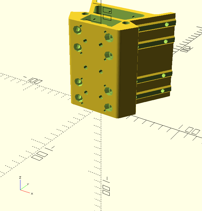

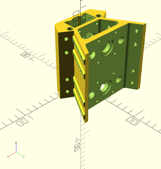

    Just in case someone wants to do DiggerJ's double lowers, here it is as one part. I was messing around in OpenSCAD this afternoon and hacked Sage's original vertex to a 100mm tall one with my addition of access holes for the stepper mounts. I left both stepper mounts in so you can use either the upper or lower position. I left all the vertical screw holes so you can have 6 bolts on the vertical also.
    The OpenSCAD file is pretty ugly right now but if someone wants it I can post that also. I'm planning to clean it up some more before I make it final.

  13. DiggerJ
    DiggerJ Journeyman
    Sep 2, 2014
    412
    109
    Interesting...except I just finished printing 9 Vertices for my test! What's a little filament between friends! I guess I can print 3 of these, and still have 6 or the normal size laying around. But in my case, that is BAD. Next thing i know the man in brown shows up at my door with motors and pulleys and heater stuff and.......

    I tried to slice those parts, and they appear to not be manifold. Ran throught the fixer and the one with pads doesn't slice well in Slic3r. Wol have to try another one. Holy Cr@p on a cracker Batman! 18 hour each for printing? I am not sure I will live long enough to print a set!

    I just through them together quick. I'll look into why they are not manifold (they should be) probably has to do with stacking three together. The pads are also way too big. I scaled those down on a normal sized vertex, still had a little pull up on one arm but way less than without the pads. I never promised they would print fast ;-)
    I just checked and OpenSCAD says it should be manifold. I'll try slicing it tonight when I get home. I just posted the STL from OpenSCAD since I've never had one fail (so far) when it said it was manifold but this is the most complicated hacking I've done to someone else's file.

    Yeah, I sliced the non-pad version, and put 2 on the build plate with the legs pointing together like I do with the regular D6 vertices and it should print (I use large brims to keep them down), and the 36 hour print kinda backed me off. That is a long time and a lot of filament to fail late in the game, that is why I backed off to 1 at a time. I am finishing some stuff for NellyBoy and then will give one a try. I don't like the holes on the outside (for the Nema screws), but totally undedstand the need when they are buried so far up into the piece. Oh well, I always say I am a function over form sort of guy! :)

    I'm not sure how you would get in there to tighten down the stepper without the access holes. They are a bit undersized at 3mm so you may need to widen them a bit to get the hex wrench in there.
    For the less adventurous, I'm actually trying a print of my own to see how it goes. With my Slic3r settings the G-Code was a whopping 105MB. This attempt will be in PETG since I've not had good luck with ABS on taller objects (need one of those fancy plastic bags I think). I'd wait until after I print at least one before jumping on the bandwagon. I didn't have any slicer issues but I'm using Slic3r 1.26 experimental. I have not tried with the older "stable" version. I plan to post all my mods in a build thread at some point, right now I'm just playing around with OpenSCAD and DiggerJ's bottom vertex seemed like a fun idea to try. I also want to punch out some three wheel carriages using the eccentric nut for adjustment that fit the Hayden Huntley mag arm design. I have that on my V-Slot 250 and it works well.

    Took all night and still has 13mm or so to go but the first tall bottom vertex being born. So it seems my OpenSCAD hacks actually worked at least with Slic3r 1.2.6 experimental. Too bad I don't have any 20x40 V-Slot handy. Looks like I may be starting that 400mm heated bed monster sooner than I thought. This is translucent blue PETG from MicroCenter. I still have not worked out making things this tall in ABS without problems (most likely need that high tech plastic bag).
