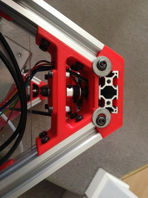

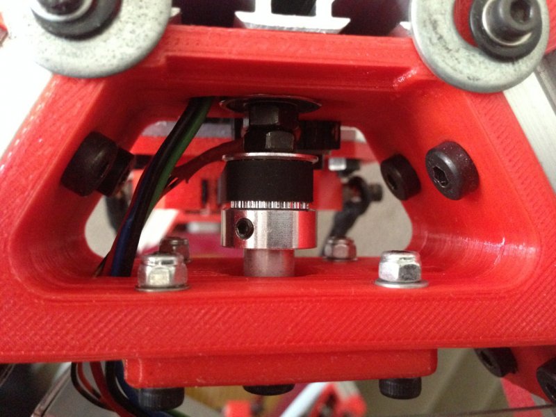

    I had a question on idler. Is the M5 bolt suppose to be able to turn? Is the pulley locked down on the bolt or does it turn free?
    Foggy likes this.
  21. lmclaren
    lmclaren New
    Mar 26, 2015
    31
    What I have done with my idler's is in the pictures, by way of explanation:
    Flat plate
    22 mm outside, 10mm inside washer (to fill the recess for the stepper and make the bearing sit flush)
    3x 8mm? outside, 5mm inside washers as spacers
    Toothed pulley(tighten grub screw).
    This assembly holds the bolt in position so it can't slide but rotates in the bearing.
    then
    Nyloc nut
    washer
    second bearing
    This stops the second bearing moving away from the upright.
    Make sure the bolt is cut short so it does not touch the upright.
    The bolt does not touch the flat plate or the 22mm washer, it runs in the bearings.
    Hope that helps, I can do a drawing if you need.

    Thanks. That does help. Based on this and Sage's original post, my guess is the M5 bolt did rotate.
  24. lmclaren
    lmclaren New
    Mar 26, 2015
    31
    Yes the bolt rotates in the bearings, if you are using a toothed idler it should be locked to the bolt so the bearing do the rotating.
