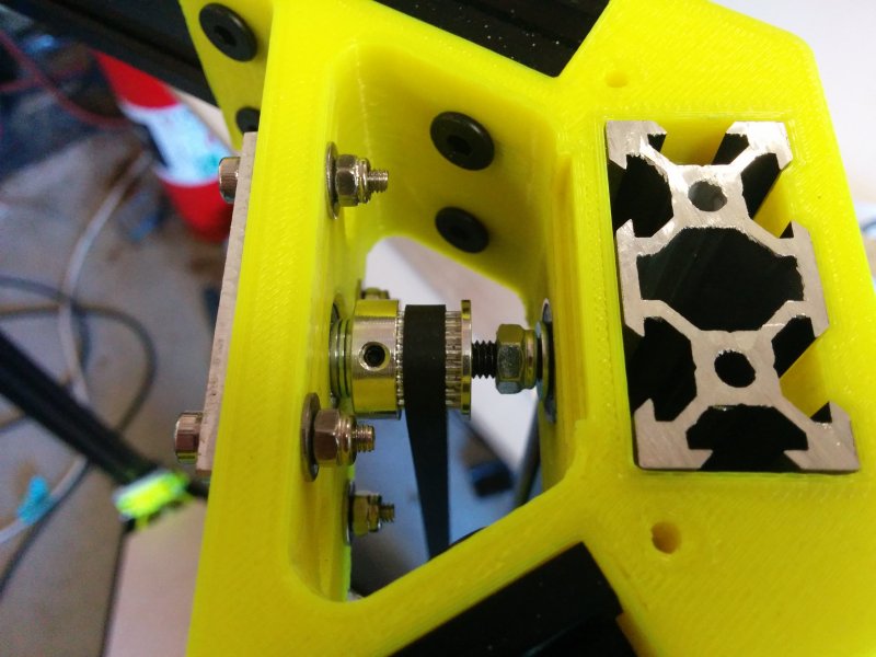

  8. lmclaren
    lmclaren New
    Mar 26, 2015
    31
    BalaKrishnan, Can you put the nut in like in the picture?
    As you can see from the attached photo of my vertex, the printed material should not go inside the channel where the nut is installed.
    Do you have a photo in the same direction as the one below?
    BalaKrishnan likes this.
  9. BalaKrishnan
    Feb 12, 2015
    26
    oh yes! I thought the screw would go with the flat side facing down.Thank you!

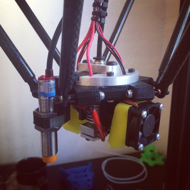

  16. lmclaren
    lmclaren New
    Mar 26, 2015
    31
    Hi Robert,
    I notice you have proximity detector, what sort of bed are you using?
    I have an unheated glass bed for testing but was going to get an aluminium bed 340mm x 4mm and put a 240v heater on it.
  17. dddman
    dddman Journeyman
    Mar 2, 2014
    468
    187
    it is an aluminum bed. 240V? Don't leave any exposed terminal! :p

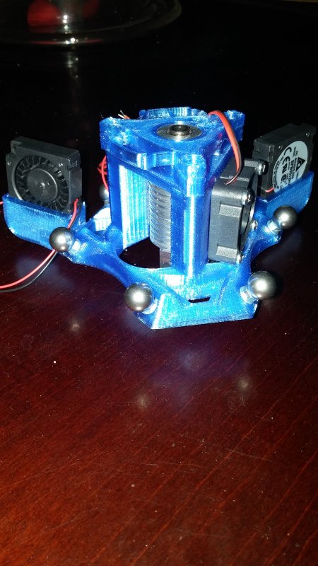

  21. Arondite
    Arondite New
    Mar 18, 2015
    36
    15
    I have officially started this build! Test fitting the length to make sure my calculations were correct. It fits the rostock max v2 heated bed from seemecnc perfectly. I wanted to leave the option for adding acrylic panels as an enclosure.

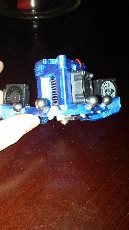

  24. Arondite
    Arondite New
    Mar 18, 2015
    36
    15
    Magnetic effector printed and ready, here's the dry fitting. It is modeled after the one I have on my Rostock

  28. Arondite
    Arondite New
    Mar 18, 2015
    36
    15
    Well here is my modified effector and the cad project(nvm doesn't allow .123dx extensions).
    I added tabs at ~5 degrees to fit these layer fans: http://www.thingiverse.com/thing:614597
    The tabs print just big enough that you can taper down the end with an exacto knife to get a snug fit.

  29. Elmo Clarity
    Elmo Clarity Journeyman
    Jan 17, 2015
    505
    149
    Printed up a test version of the file last night. Bit tight of a fit for my E3Dv6, but nothing a little time with an X-Acto knife won't fix. Is there another file for the top part that locks the hot end in place?
