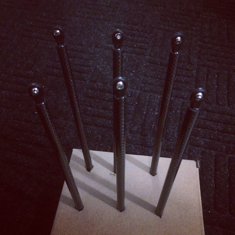

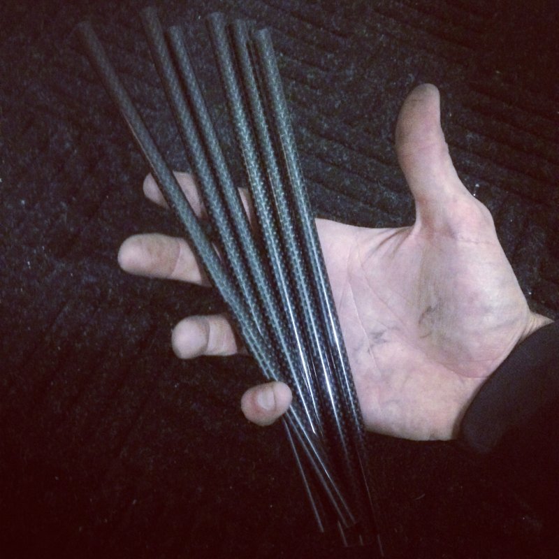

    Where'd you get the carbon rods?
  7. Scott Baker
    Sep 23, 2014
    After a long hiatus (f*ck you, cancer!) I am starting back up with my Δ6 build again.
    I've got my frame completely put together, the carriages are installed as well as the motors and idlers. I've got my carbon fiber rods ordered as well as a a 24v power supply.

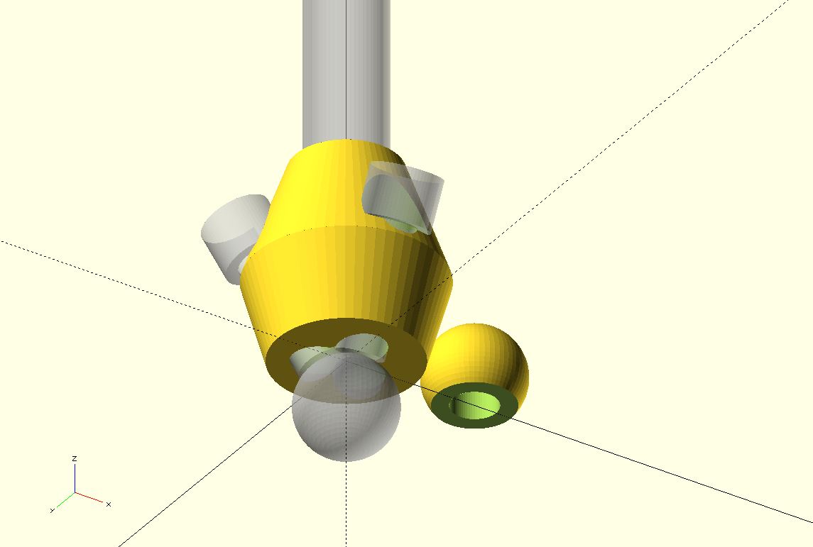

    Interesting, I'll have to print this and mess around with it. I'm curious if the 3 magnets creates more friction on the steel ball than a plastic cup. The one's I've been printing have ~0.25mm gap between the steel ball and the magnet.
  22. David Bunch
    David Bunch Veteran
    Oct 27, 2014
    624
    434
    I made the plastic ball more for testing than using in real situation. I was planning to use something like steel ball bearings if I implemented this. When attaching the magnets, you might want to have their magnetic poles in the same direction for consistency. It does not seem to keep any of the three from connecting to a steel bolt head.
