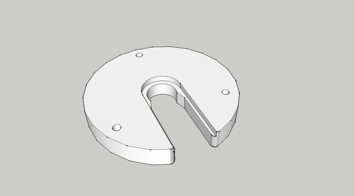

    I got a E3D v6 hot end and the groove mount jerry supplied us didn't fit so I created a E3D v6 groove mount based off of jerry's. See attached.
    I wanted to thank jerry for all his work on all this. This is the first build I've done and things are going quite smoothly!

    I suspect you noticed the E3D groove does not want to snap into final position as if my design isn't quite wide enough? I designed it to be very (VERY!) tight and I use this tool to make it go:
    Thanks for your thanks. I have 13 of these (in 3 different sizes - 400mm, 320mm, and 240mm) completed at the moment and all are working flawlessly thus far. I have some of them running 24/7 for many weeks at this point. I'll have 20+ of them running soon just to keep up with what I've stumbled into :)

    Ah, I just took a look at the measurement drawings to compare the E3D V5 and V6 and they are in fact the same diameter. Your hot ends must be permanently in those groove mounts! :p
    Oh well... with the one I made it's possible to snap the hot ends in with my hands. We'll see if it stays well enough in place.

    I think they're almost permanently in the mounts - it would take considerable effort to remove them. I didn't want any chance of the hot end working itself loose so I may have overdone it with the tight fit. Your design may prove to be more than good enough.
