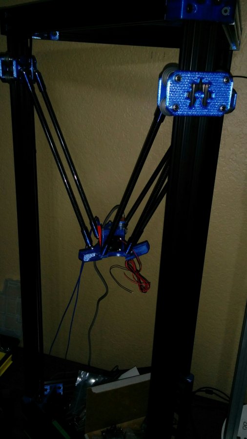

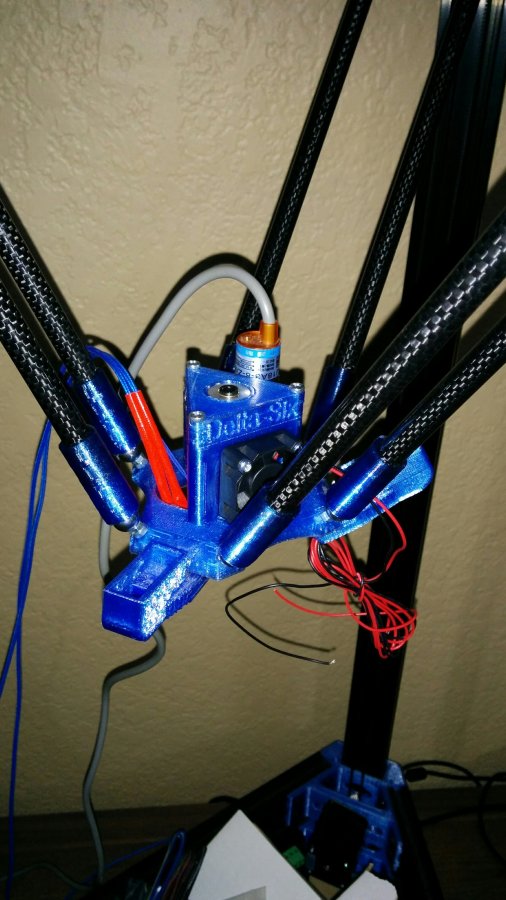

    Hey all,
    I've finally found the time to come back and finish this project, life hit me hard there for a bit. I still need to print an enclosure for the panel and power switch, and I'm dialing in the zprobe autocalibration on the smoothieboard. Otherwise it seems to be printing absolutely fantastic, much better than my Rostock Max.
    I had quite a few issues though, the first smoothieboard and all three of my external stepper drivers were bad which is a huge hit to my wallet. This means I'm running at 1/16 stepping instead of my 1/32 to 1/128. I still see some of the vertical banding I was getting on the Rostock, but it's much more spread out, and doesn't protrude nearly as far. I'll print with the built in drivers for a bit before I order anther set of the external ones.
    This is the best I've printed PETG too, there's almost no stringing and the oozing is limited to the top layers on multiple prints. Here's some pics:
    EDIT: I'll upload my models later this evening
