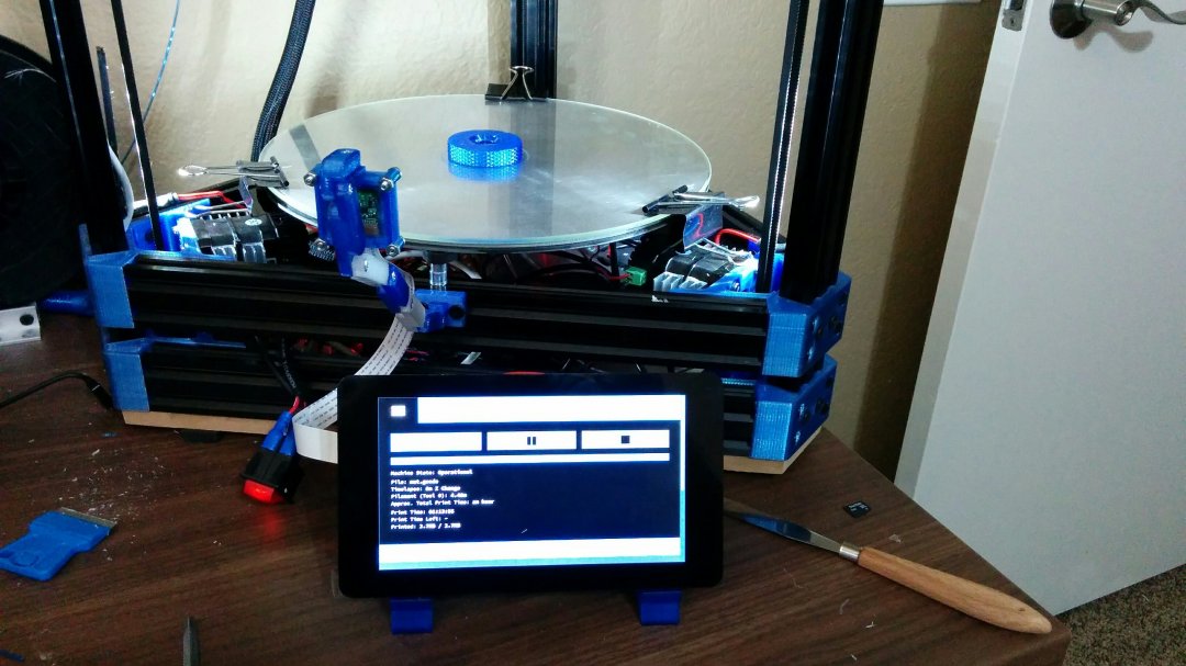

    Finished my Delta6 and thought I would share some pictures of it. I used several modified parts for the printer.
    The printer in all its glory. Just ignore the junk around it. It is powered by a Duet 0.8.5 controller and I have installed a 4.3" PanelDue display.
    Some closer images of the display...
    Still working on a status panel to show if the heated bed or hot end is on...
    The heated bed is a 250mm Mic6 aluminum build plate with a 10" Keenovo AC heater. I made some covers to fill in the space between the bed and the towers.
    The printer uses a 12v 8A power supply. Was playing around with changing filament colors when I made the enclosure for the power supply. There are two 40mm fans on the back blowing onto the power supply. I built a little power distribution panel for 12v connections. Only using 2 of the 7 outlets right now.
    The heated bed is controlled by an AC SSR. I have connectors for the bed so I can easily remove it to get at the insides.
    The effector is a modified version of Arondite's effector. I have an E3D V6 hot end and DC42's Mini IR Probe.
    Mounted some 5mm LEDs on the effector. They are controlled by a pin on the Duet board.
    The carriages...
    The ring at the top was for mounting a flying extruder, but couldn't get that to work right so went with a bowden setup for now. I am using an E3D Titan extruder with a pancake motor.
    Have printed a few things with it so far. First thing I printed with it was the 3DBenchy and it came out nearly perfect with out doing any tuning of the printer before hand.

    Looks fantastic! I really like how clean your electronics are, and it looks like you planned ahead for a future flying extruder ;) I've been considering moving towards that setup. How's the Duet? I've been using smoothie and have had a rocky experience with it, although I probably spent less going smoothie a raspi/touch screen than Duet with the paneldue haha
    Do you mind sharing your files? I'd love to print out the panels you have around the heated bed.

    It's really not for a "future" flying extruder. My original design had one. I just ran into too may issues with it that I switched to bowden until I can get those issues worked out.
    I love my Duet. I have two right now. One on the Delta and one on my C-Bot. The C-Bot has a 7" screen. I like the 4.3" one, but might switch to a 5" later. I am thinking about modifying my Printrbot Simple Metal to use a Duet board. I originally tried the Smoothie. While the hardware was nice, the software left a lot to be desired. It has been awhile since I used the Smoothie so I'm not sure what has been done with the firmware since.
    I did the panels using OpenSCAD. I'll include the file and you can modify for your needs. The file contains both the bed mounts and the caps.

    The towers are about 700mm tall and the cross pieces are 300mm. We (a co-worker is also building one and did the cutting) took a 1 meter V-Rail and cut exactly 300mm from it and then we trimmed the tower pieces to the same height.
    I got the magnet/ball/rods from Ultibot and the rods are 288.27mm long.
    I have a comfortable print diameter of 240mm but can push out to 250mm if I have too.
    Build plate came from Midwest Steel Supply. We cut a 300mm square to a circle about 265mm in diameter. I have a 250mm piece of PrintBite attached for the surface. The heater is a 400W 120V 10" Round Keenovo I ordered from Amazon. Check both eBay and Amazon for them as sometime one will be significantly less than the other. But both are ordered directly from Keenovo.
    I haven't seen a need for diagonal supports so far, but have only started printing with it. This is my first delta so still learning the differences with this type from cartesian and core xy style. It is pretty solid so I don't think extra support will be needed.
