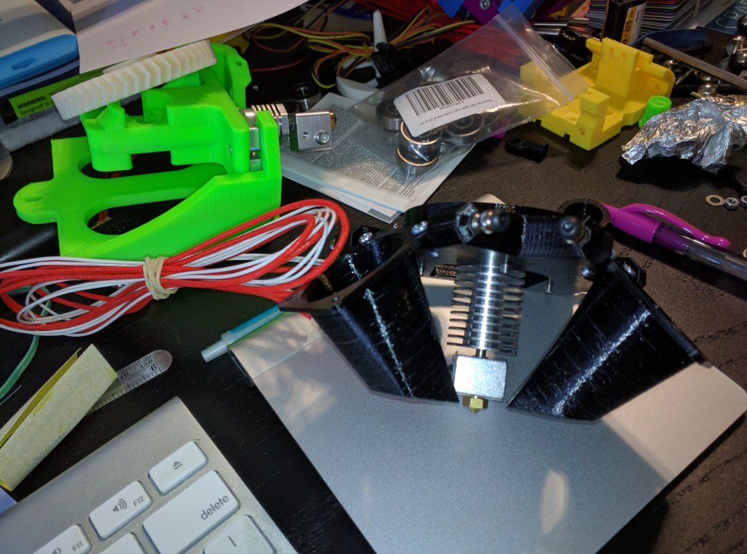

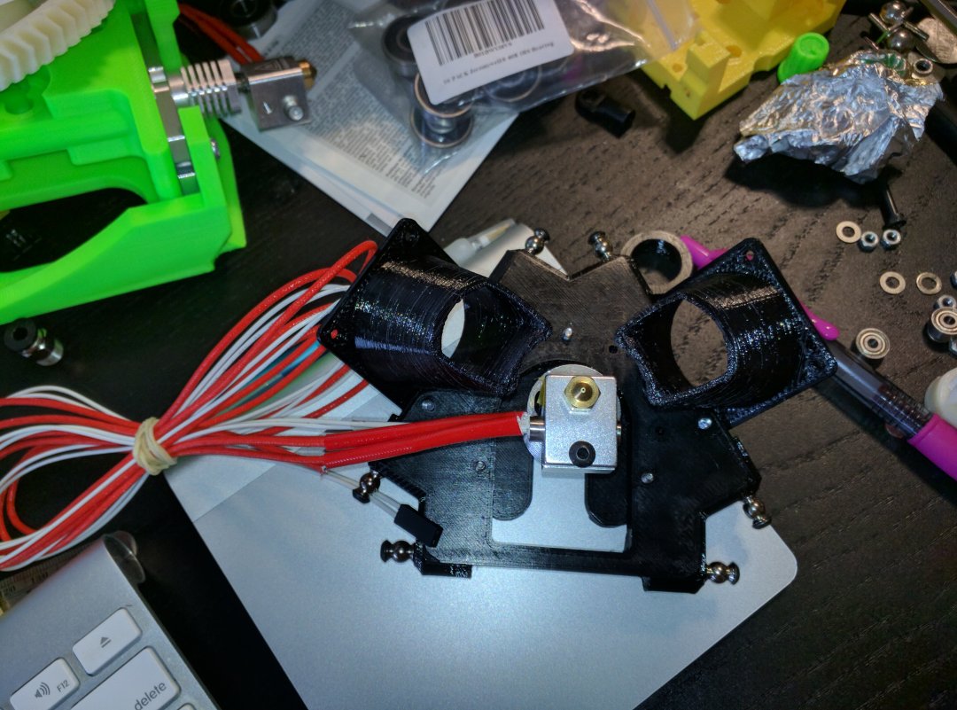

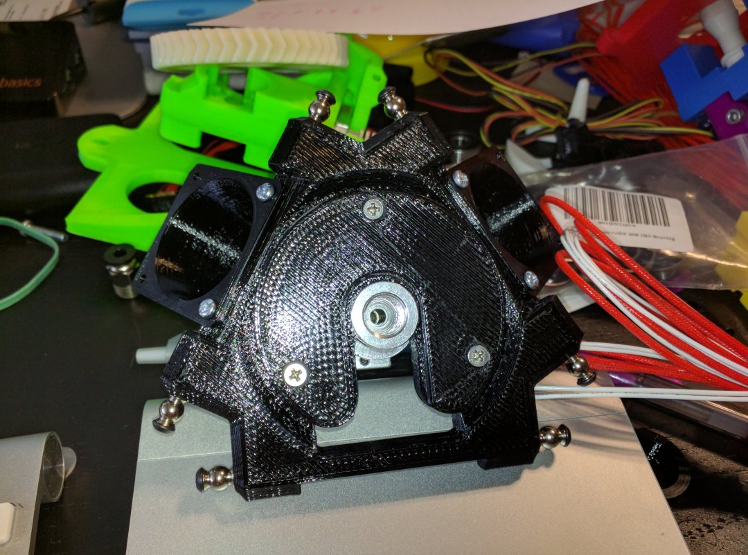

    Since I've decided to go for the Compact Effector -- what have people used for an auto-leveling probe? I'm now at the stage where I need to pick some kind of auto-leveling mechanism for the build. With a build this large, I have to reject the FSR-style leveling simply because the heated bed will destroy that kind of leveling probe ... FSR's melt.

  24. David Bunch
    David Bunch Veteran
    Oct 27, 2014
    624
    435
    I am using an inductive proximity probe on my Delta which I am happy with. If you are using a glass bed, here is an interesting method to use an inductive probe with that. Inductive proximity z-probe adapter. Works with glass cover. by paul_delta
