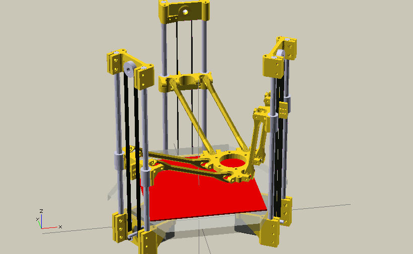

    What is the length of the rods?
  14. dddman
    dddman Journeyman
    Mar 2, 2014
    468
    187
    To answer to my own question, Robert has found that the rods shoud be about 40% of your printer height

    I thought rod length was at 80% of horizontal distance between vertical posts?
  18. Nugz
    Nugz New
    Oct 8, 2014
    58
    @DiggerJ
    I think you are on to something Digger. The rod length should be derived from the size of the build area and the distance between the vertical posts. It has little to do with the height of the vertical posts.
  19. DiggerJ
    DiggerJ Journeyman
    Sep 2, 2014
    412
    109
    Yeah, somewhere I was reading that the height of the printer has little to do with the rod length. The situation is supposed to be to figure that when the hot end is at the far side of the circular heat bed, that the carriage rod needs to NOT be fully horizontal. It needs to be up by some percentage to prevent force at the far end. It is also supposed to keep the effector from clanging into one of the other uprights. I will try to find the article that explained it in details an idiot like me could understand. I tough the taller the printer, The longer the rods, but I guess not.
  20. Nugz
    Nugz New
    Oct 8, 2014
    58
    @DiggerJ
    What you said makes perfect sense to me. I'm no math wiz so I cant figure it out with Trigonometry, but I'm sure I could come close enough with a tape measure and a mock-up. :D
    Let me know if you find that article. I would like to read it also. :thumbsup:
    -Nugz
  21. dddman
    dddman Journeyman
    Mar 2, 2014
    468
    187
    Want to know something funny?
    40% of 600 is 240
    80% of 300 is 240!
    DiggerJ and Robert Hummel like this.

    The info I found explained that the bed area should be doubled to get the proper height of the printer in turn making the 40/80% rule apply
    There is really no distinct formula to follow from my findings and even if you could reach your rails you will still have a max travel set so longer arms are not really an issue IMO if you have the travel space in your Z axis
    It's if you make them to short that problems will arise.
    As said before the main thing is not having the arms fully extended in turn causing a force/kickback
    Nugz likes this.
  29. DiggerJ
    DiggerJ Journeyman
    Sep 2, 2014
    412
    109
    Yeah, I found a guy last night that applies the rule we have been discussing and adds 50mm to the length of the rods to avoid any problems. I just hope to get to the point that all of this enters my build...soon. When I get off of work today, ny first 3 vertices and all three carriers fro the uprights should be finished. I will start the next three certices when I get these off. Thant shoulf get me well into the build. I already have moters and wheels. Electronics are coming from BandGood and balls and magnets are on the way. Just need to order Boro, heater and Power
