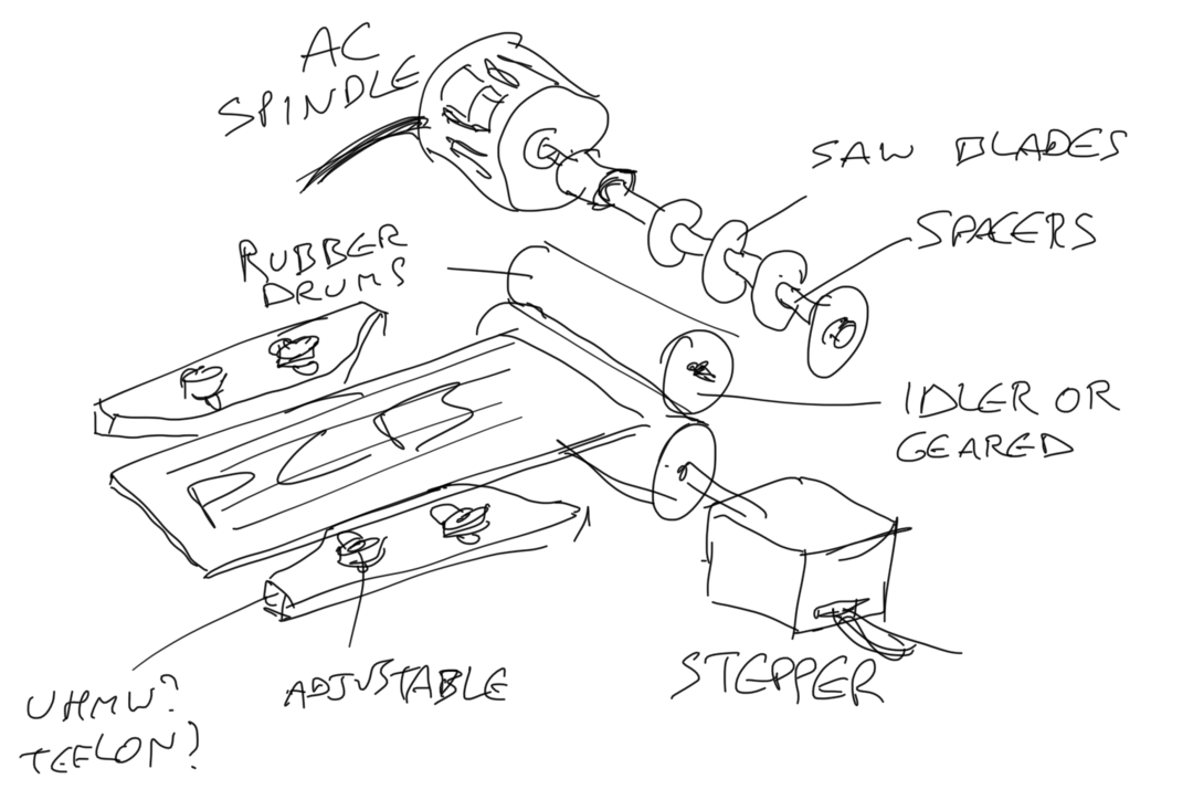

  7. Rob Taylor
    Rob Taylor Master
    Dec 15, 2013
    1,470
    755
    Real quick sketch in Apple Notes. Simple, rugged, minimal programming/simple control.
  8. alepiedi
    alepiedi New
    Dec 5, 2019
    Yes, the idea is this, even the simplest to make but considering that PCB is about 150cm the machine will be more than 300cm.
    So, if it's possible to realize a movable rotary shaft in max 200 cm it would be better.
    Do you think is possible to realize your idea but with a movable rotary shaft?
    Thank you
  9. Rob Taylor
    Rob Taylor Master
    Dec 15, 2013
    1,470
    755
    There's no reason to have a machine longer than about 50cm. Just as a planer can plane lumber many metres long.

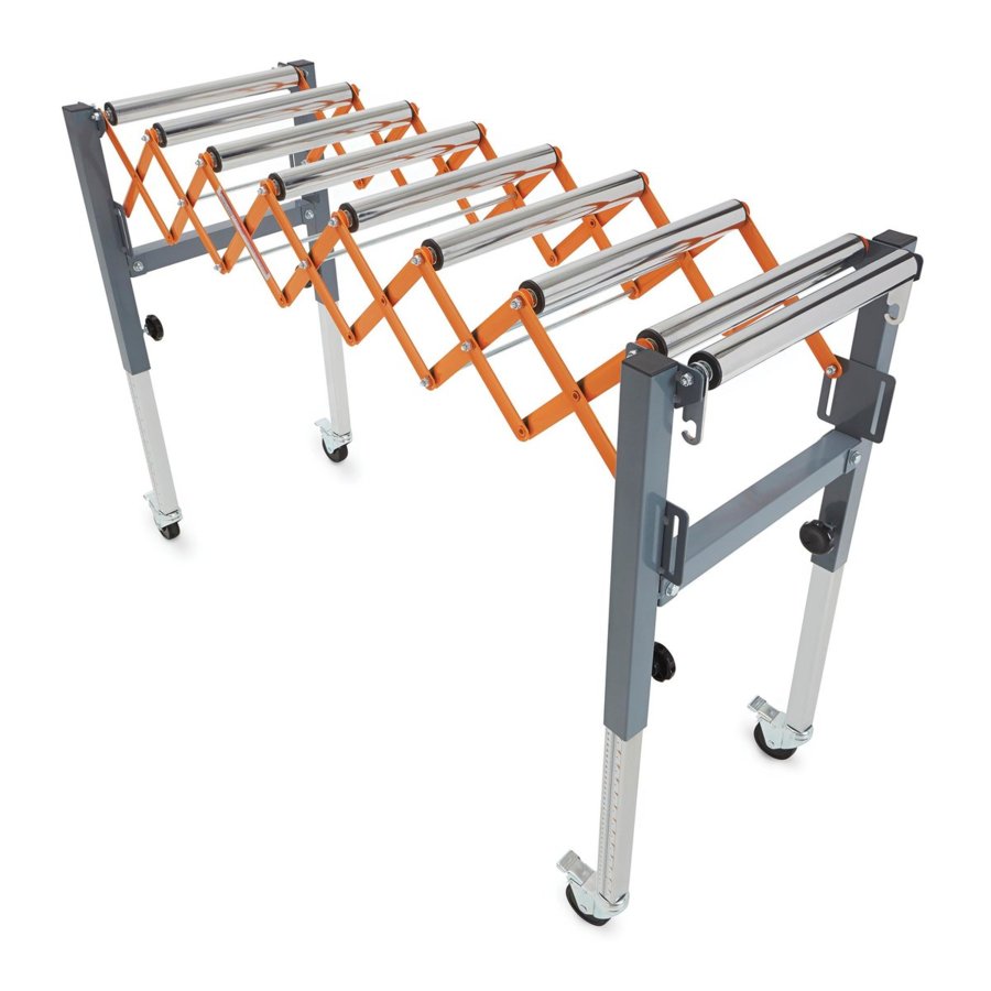

  13. Rob Taylor
    Rob Taylor Master
    Dec 15, 2013
    1,470
    755
    Yeah, a set of expanding portable feed roller conveyors doesn't seem like a huge deal:
    But if the space is non-negotiable, you're going to be stuck with a single-axis CNC "power feed" machine, inherently limited to what dimensions it can process, more complex, more expensive.
    Since you're doing this commercially, why not just rent a space it can be done in? You're gonna need the expansion room at some point anyway.
    A 1500mm *operating range* machine is going to be... Interesting. 1500mm material gives you an actual range of motion of somewhere around 1100-1200mm, typically, when all's said and done. Even if you screwed directly to a tabletop with no end supports, you'd be looking at a maximum of 1400mm, since you'd need at least a 100mm carriage for the gantry columns.
    So you really need to find 1800mm rail if you can. Chain drive could be another alternative to rack and pinion. If you tension it right, it should work just as well as belt but at very large lengths. Could even do continuous loops not even connected to the rails, just mounted to the table at each ends. Personally I'd go rack and pinion though.

  14. alepiedi
    alepiedi New
    Dec 5, 2019
    This project is for my graduation thesis and I realize the machine for a company that gave me this opportunity.
    My initial idea was to realize a machine like this:
    But the company told me the problem about dimensions (more than 3 meters) so I thought about the machine I told you.
    I realize the difficulty in realizing that type of machine so insert in the final part a portable feed roller conveyors could be a great solution.
    In the initial part the ideal would be to create something like this with some UHMW guides to keep stable and in correct position PCB and at the same time motorized to bring it in the cutting phase.
    Right?
  15. Rob Taylor
    Rob Taylor Master
    Dec 15, 2013
    1,470
    755
    Yes, precisely.
    I suppose, since it is a university project, bringing them both options and designing around limitations gives you something more to write up in your final report.
    Either way will work, but the conveyor feed is a) faster/more productive, b) allows for simultaneous loading and unloading by two operators, c) could spit the cut boards directly onto a rolling cart, where they can be moved to another work area for assembly, d) is the all-around better choice for lean production.
    We'll see what they choose, though.
