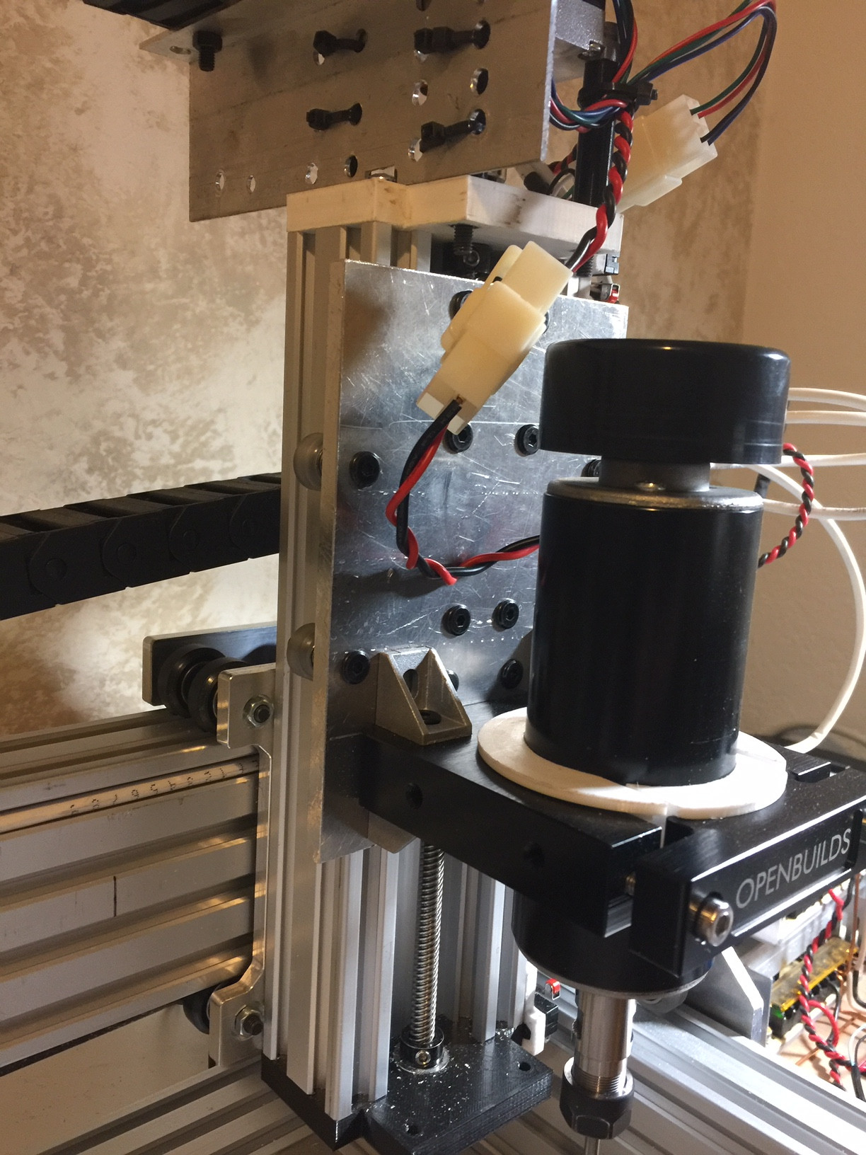

    Well I bought some Elairecorps collets the metric pack for now. Price is up there. I probably wont get rid of the 500w spindle as it seems to work on everything just a little slower. I'll Keep it for the smaller endmills stuff. To have all the ER11 collets kind of make you spoiled. Biggest thing now is dialing the use of the Makita. Current i have just put my Z axis back together using the linear bearing rails MGN-12H. Last cut I did was on the mini v wheels on hand drilled plate the proved to work but for aluminum I was finding I was readjusting and re tightening the wheels all the time after every part. And I would have these weird unexplained crashes that would that I think might have been caused by the spindle vibrating or bouncing. Here's a few pics thought I would share the evolution of the machine.
    [​IMG]With this setup I was able to cut the holes on this plate but i still couldn't cut the part out.
    I cut bored and made holes in this plate.
    [​IMG]Now this is the setup to stop the flexing or vibrating of the spindle. Plus the Makita felt to heavy for the other plate and one spindle mount.
    Thanks for advise! Oh alittle scotch bright almost makes it look like i know what i doing.
