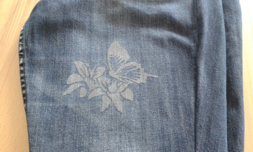

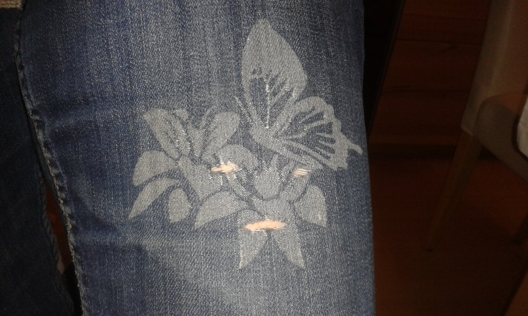

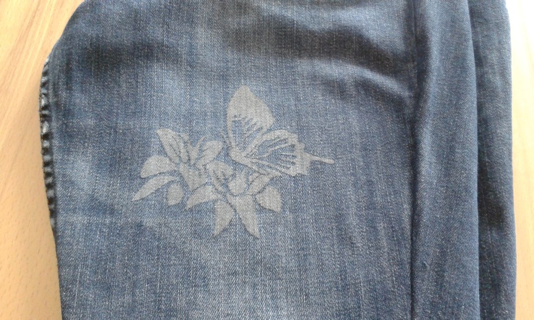

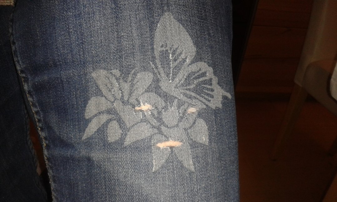

    Hi Scotty,
    jeans were manufacted in different qualities, so you get also different results. :(
    The fastest Speed I've ever tried is 800 mm / min, but I think it can be faster.
    I have tested the same power with faster speed (800 mm/ min). The pictures were be not so bright.
    Some weeks after lasering, the pants are torn (the same setting as my "AK Logo"). I think, a little to much power for "this bad jeans quality".
