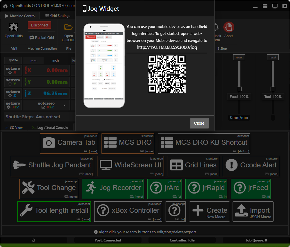

  7. sharmstr
    2,059
    1,449
    That's mine and it wont help him.
    @Matt Petersen as Peter said, getting info back to a custom pendant is a lot of work. The interface is great but if you cant afford it now, then some cheap solutions are
    1 - Use the jog pendant already built into Control. I have an old phone I use for this purpose.
    2 - Use a cheap xbox controller with anitmcrox: GitHub - AntiMicroX/antimicrox: Graphical program used to map keyboard buttons and mouse controls to a gamepad. Useful for playing games with no gamepad support. . I'm currently working on a macro for this that will change the jogging feed rate based on the joystick position. Should be pretty slick.
    Both of those solutions are better than what you're trying to do.

  9. Ivo Beltchev
    Apr 17, 2023
    32
    15
    @Matt Petersen, this is my pendant solution: New pendant project
    It implements a two-way communication with the PC, which allows for a much better integration with the Control software.
    My pendant has its own step setting because the wheel produces a lot more pulses than you can do with the keyboard, and sharing a setting with the GUI won't make sense.
    But to answer your immediate question, you can check if one of the step buttons is pressed using this code $('#dist01').hasClass('bd-openbuilds').
    As others have said, I would advise against sending keypresses, because those can be reassigned and may not be interpreted the same way depending on the current context. Like, if you send an arrow key while the cursor is in a text field, it won't actually cause a jog.
    It's better to read the pendant input from a Javascript macro and generate G code directly using the sendGcode function.
