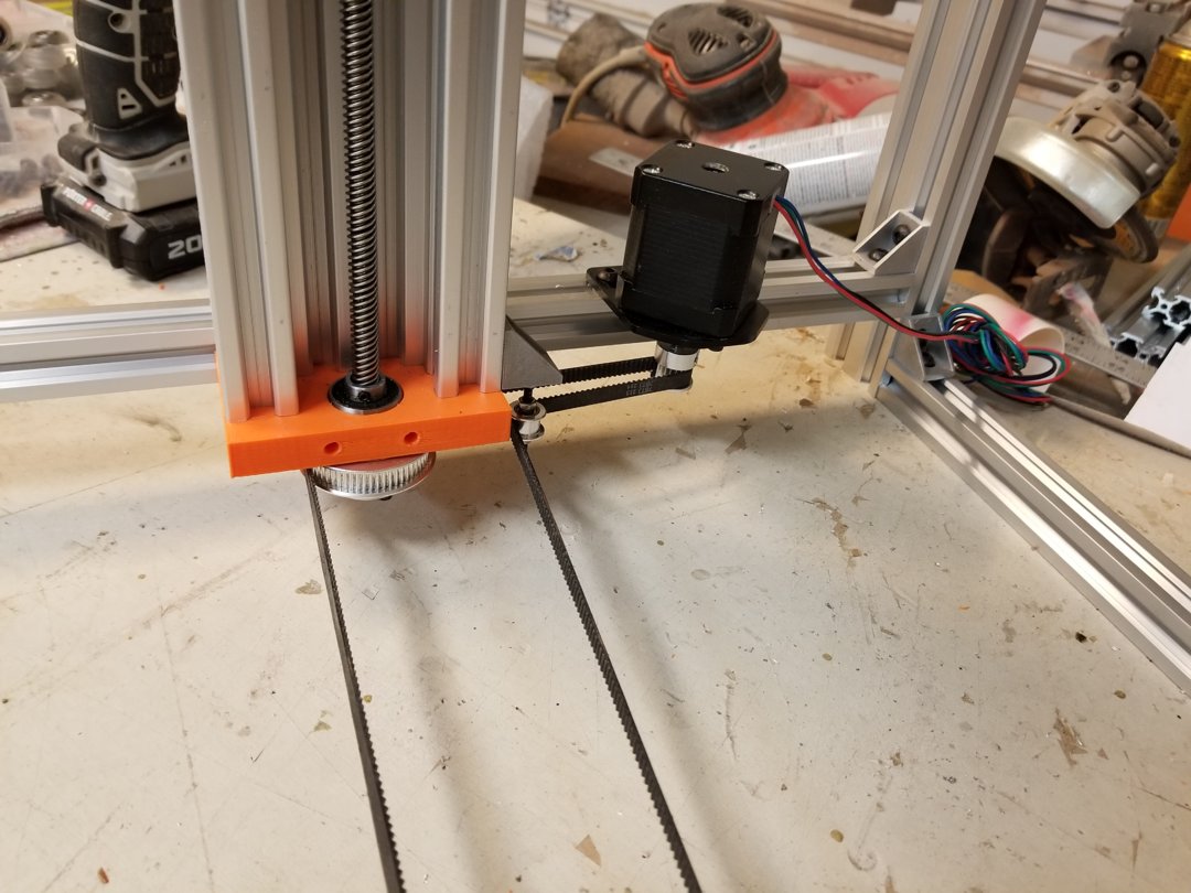

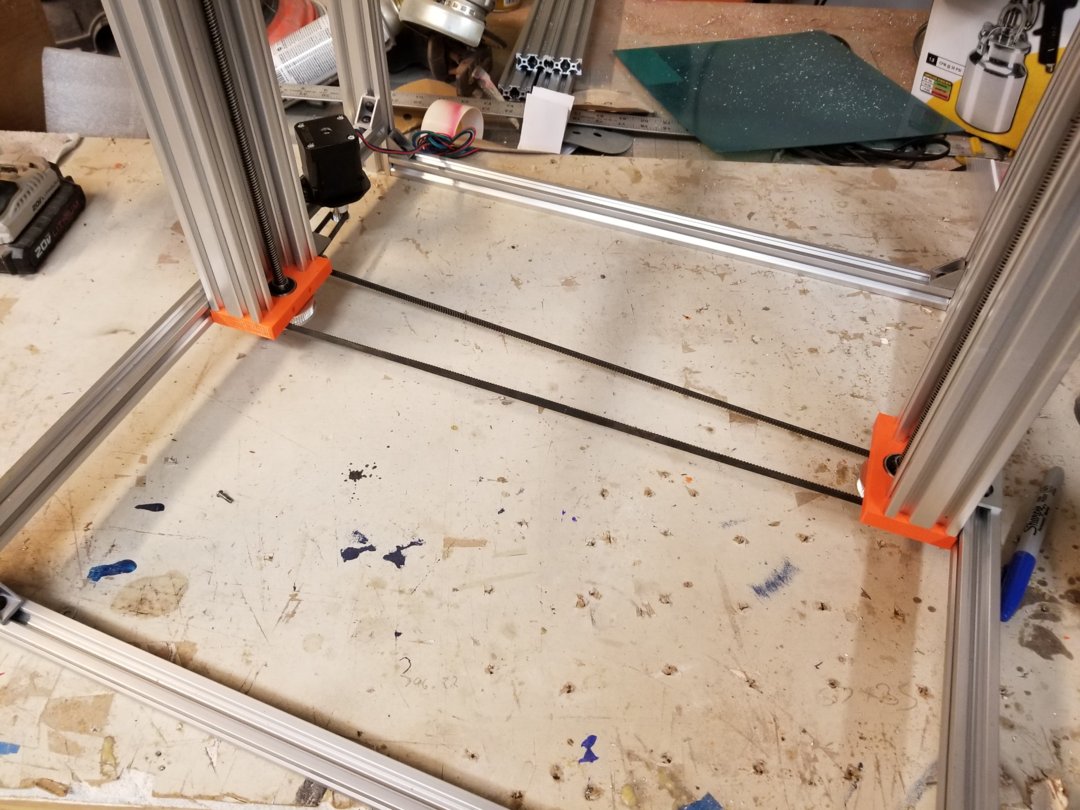

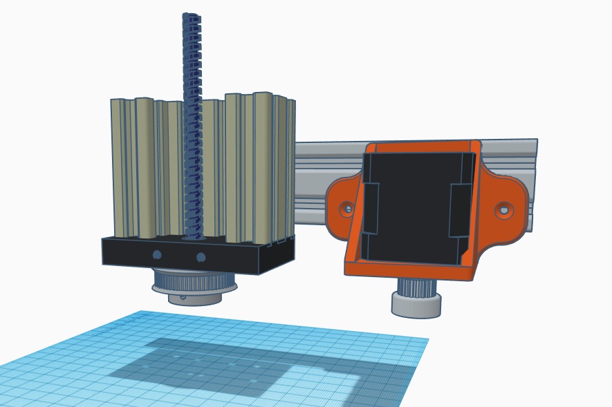

    Ok, I had an epiphany last night on a clean way to drive the z axis without using a Nema 23 / external driver and reduces the belt path quite a bit. I originally had my bed (which is quite large and heavy - 1/4 MIC 6 aluminum plate 15"x15") being driven by a single Nema 17 but using reduced gear ratio of 3:1. It had no problems moving the bed up and down. What do you think of this? You can slide the stepper mount along the 20x40 rail to add tension, no idler pulleys necessary. Also, no need for that long 20x80 piece between the 2 Cbeams cbeam_sample.jpg
    #44 Troy Proffitt, Jan 23, 2019
  15. fillefrans
    Nov 11, 2018
    Hi Troy, if I understand the setup correctly you'd get less than 25% contact between the belt and pulley closest to the motor? I'm not sure what's recommended as minimum, but that seems less than ideal?
  16. Troy Proffitt
    Troy Proffitt Journeyman
    Oct 11, 2016
    126
    107
    It would be quite easy to add an idler between those to pulleys to increase the contact, but it shouldn't be necessary. I'm going to be trying it out this weekend on a new D-bot build, and I'll take some pictures.

    Just so you know, the new idea still uses a single stepper, but instead of a Nema 23 + external stepper, it will use a single Nema 17 that is driven off your main control board. The torque is there due to the gear ratio of 3:1. Overall, it's just a simpler design.
  19. CFerguson
    CFerguson New
    Dec 6, 2018
    oh, I see what your saying. The picture doesn't quite represent your actually motor position in relation to the lead screws, I misinterpreted that. That looks like a good way to do it, and you can keep the motor external of an enclosure that way too, which would be nice.

    Ok, got it hooked up. Works very well!

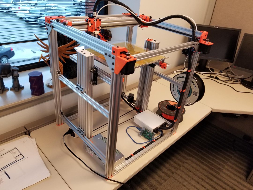

    Printer is finally done. Delivery to new owner today!
    Doug Wilson, patnap71 and GrayUK like this.
