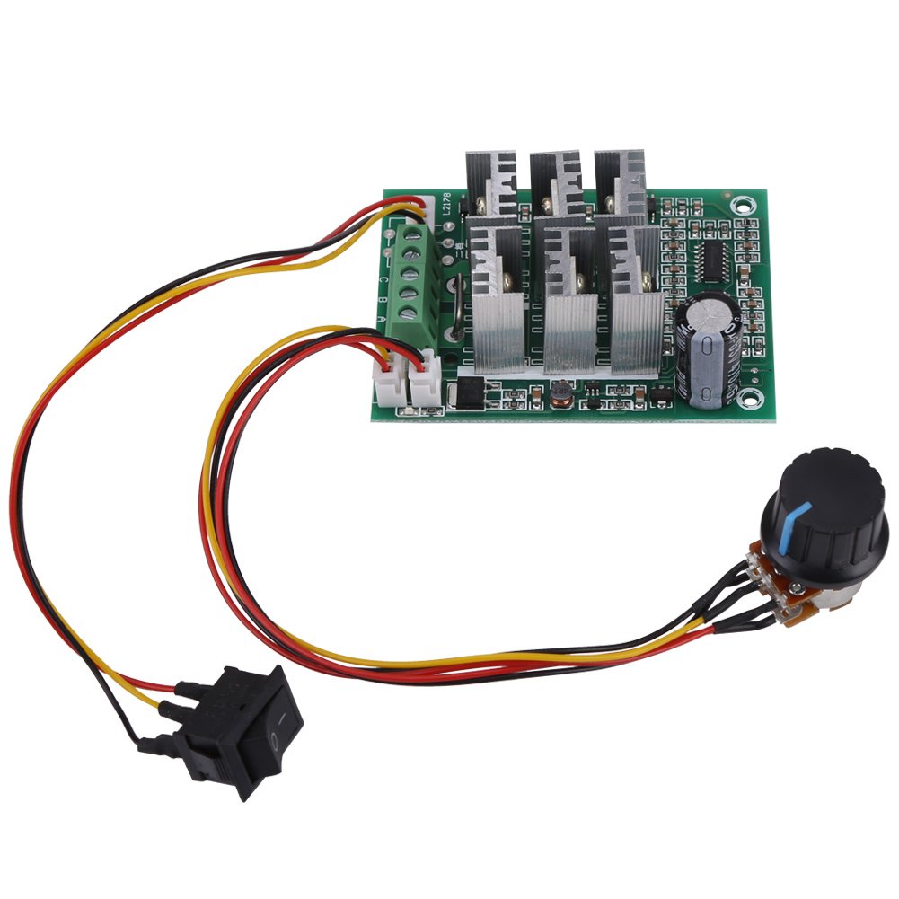

    I'll probably start a new thread about this upgrade but just for posterity sake, I'll add it to the overall build thread as well. I am currently testing out the concept of using an external air source for my parts cooling fan and using a long CPAP hose to attach to the print carriage. This should provide 2 advantages...Firstly, if I ever enclose my printer, since the air source is external, it will be pumping cool air onto the print object. Secondly, it should lighten up the carriage and reduce vibration (I currently use 2 50mm fans attached to the print carriage).
    For the air source, I took apart an old CPAP machine and retrieved the 3 phase centrifugal fan:
    To control it, I ordered a 3 phase 12v controller off Amazon:
    This includes a switch to invert the direction of the motor and a potentiometer to increase / decrease the speed of the motor. I used the 12v 5amp power supply that came with the CPAP machine since I felt like this would be too powerful for my Duet2wifi controller so I purchased a DC-DC relay so that it will use the printer controller fan voltage to signal the relay only. To protect everything, I went to Home Depot and purchase a little electrical box and drilled holes to accommodate the input air for the fan, the fan speed control and wires.
    Finally, I needed to re-design my D-bot carriage to receive the incoming air source and divert it to cool the print part. Right now, I'm waiting for the 1/8th inch to 3/16 barbed tubing connectors to come in the mail so I can put everything together. Also, while I was at it, I'm transitioning to an E3D Volcano hotend (can't hurt right?) More pics to come.

  29. Troy Proffitt
    Troy Proffitt Journeyman
    Oct 11, 2016
    126
    107
    So I finally got the CPAP blower working on my printer. Works great! I have the blower set to a very low RPM and it still puts out more air (and it's cold air since it's away from the bed). Here is a video of it in action:
