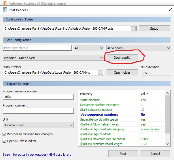

    Hi @ian McFadden, I would be grateful if you could cast an eye over the attached Fusion post processor and tell me if I have correctly incorporated your wcs changes (with some modification for the new beta 3 firmware and Duet Web Control-2 from Ooznest - I have allowed up to 6 workplace offsets as we are now using G53 as absolute[machine] co-ordinates).
    Alex.:):)
    PS that worked fine with one wcs (once I had learned how to use multiple wcs in Fusion).
    Also worked fine with two work offsets - because I'm using a modified version of my toolchange post processor it puts macro calls between each toolpath so it should be simple to write those to make sure there is a clear path around any fixtures at each wcs change.
    #91 Alex Chambers, Oct 19, 2019
