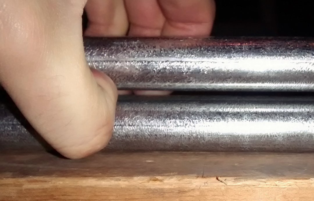

    Here's a picture of the completed top and bottom:
    And here's the flexing at the midpoint of one of the towers:
    I'm thinking that adding 4-5 of those ribs between the tubes should reduce this issue drastically. I'll see about getting some of those spacers printed over this weekend.

    That is looking pretty cool. I will be interested to see how you incorporate those spacers. One thing I noticed with my assembly in openscad is you might have to adjust the top idler offset and or the motor plate for proper belt alignment. With the design like it is, this should be a lot easier to adjust than having to modify the vertex parts. I had to adjust the taper shim 2mm shorter to get a better path for the belt.

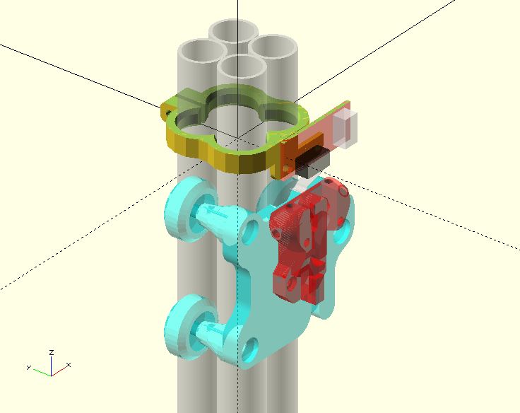

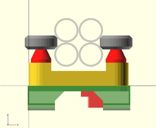

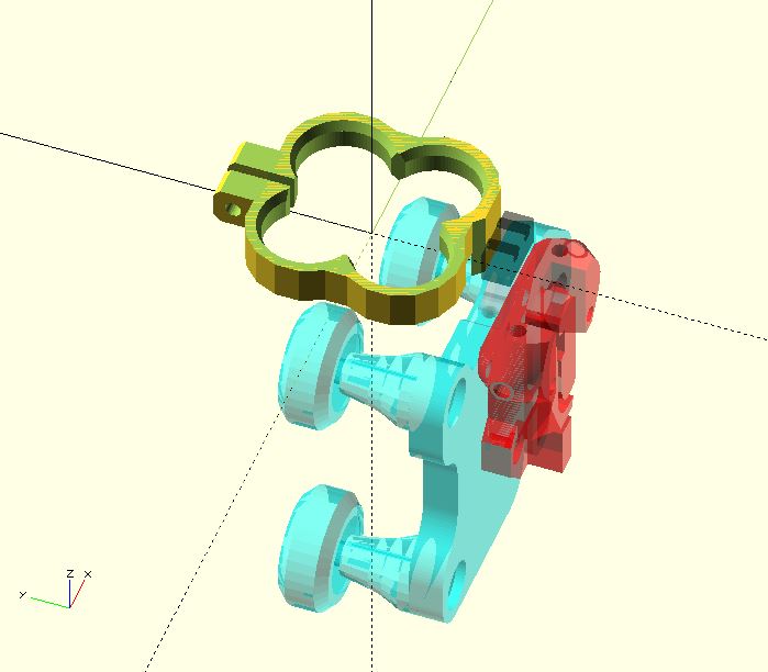

    In case you want a slider that will give you a wider Arm spacing, I modified Jerry's Delta-Six slider to make it more customizable & think this should work with the full size Wheels. Where the rod ends connect to the carriage is 75.2mm. Of course you should be able to use a different carriage with it. Here are a couple of screen shots of the design. I can add the openscad file if you want, but it needs a little more tweaking to adjust other options.
  4. Cobalt Griffon
    Oct 5, 2015
    20
    Hi David,
    I've already printed your remix of the Folger Tech carriages and sliders, but having some other options is definitely good. As to the arm spacing, I'm only planning to mount 1 Prometheus series hot-end on the effector platform, so something the size of a standard Kossel effector should work just fine.

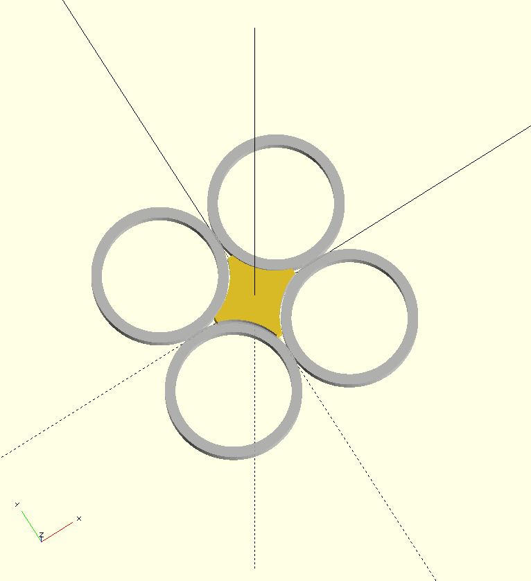

    If you have not glued the verticals together yet, here is another solution that should work. You can use this jig to drill 2 holes in the vertical pipes at each spot you need to pull the pipes together & use 2 screws with locknuts to pull them together. The 2 holes are offset by 11mm to miss each other, but probably could go less than that. You might need to do this at 3 spots for your long verticals. The length of screws will probably need to be 50mm or 2". The variable Dr_Hole_OD = 4.5; sets the diameter of the hole you want to drill. I was initially thinking of drilling 4 holes, but then realized that drilling 2 holes diagonally would probably work better. Just have to make sure the screw head or locknut do not interfere with the carriage. I included a screen shot, STL file & openscad file.

    Nice jig for bolting the towers, I've just glued one of them up with the printed spacers, I'll post some pics of the end result later tonight. I've also posted some more pictures of the triangles on my blog: Cobalt Griffonary: Project: Proteus Delta part 1

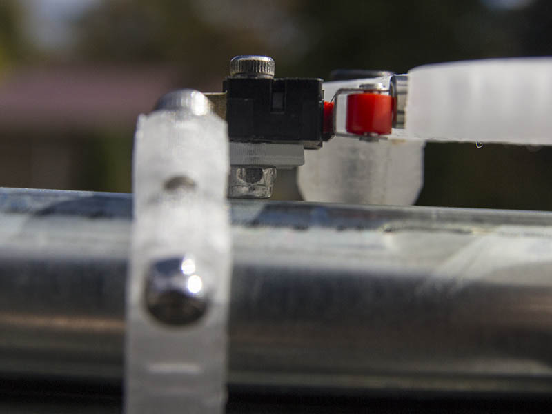

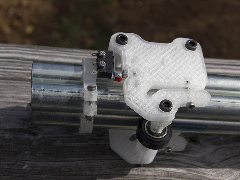

    What kind of limit switch & have you figured out how to mount that? I was working on using the limit switch board like the one used on the Folgertech Kossel & this is what I have so far. It currently does not quite match the micro limit switch bolt, but should hit the carriage or slider. Here is a screen shot & a STL file if you want to take a look at it. With the Duet board, you might be using something completely different.
  8. Cobalt Griffon
    Oct 5, 2015
    20
    Hi David,
    I'm using this micro switch:Endstop mechanical limit switch with wire (for delta )
    It's basically the switch from the Folger tech module, just without the circuit board :)
    Dimension wise, the screw holes are 2mm on a 6.15mm spacing, width = 12.7mm, height = 6.5mm, and thickness = 5.8mm
    I'm using the exact same switch on both of my previous deltas, and they're very reliable.

    That switch should work better in that tight area. See if this will work for you. I made this 3mm thick instead of 4mm as it did not seem to be that thick with just a limit switch attached. Should only take a half hour or so to make a test print. I thought about making the bracket an optional 2 part bracket in case it needs to go on after the top vertex is on, but rotating the clamps 90 degrees which I thought would be the best orientation causes the top wheel to hit. It is great having the assembly in place while designing to see those problems without having to do a test print. I could probably make it a 2 part bracket by rotating it 45 instead of 90. I might look at that tomorrow just to see if it would be a good alternative.

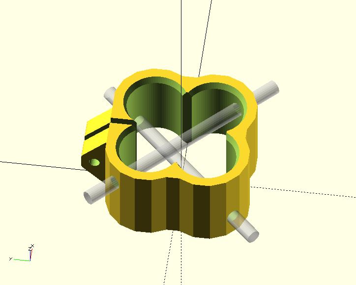

    Here is a 2 part bracket design to test if you prefer this type. I rotated the tightening mounts 45 degrees to miss the upper wheel & switch. Looking at this further, might have to recess those M2 nuts & shim the M2 screws out to get just the right length for the screws so they do not hit the vertical EMT.

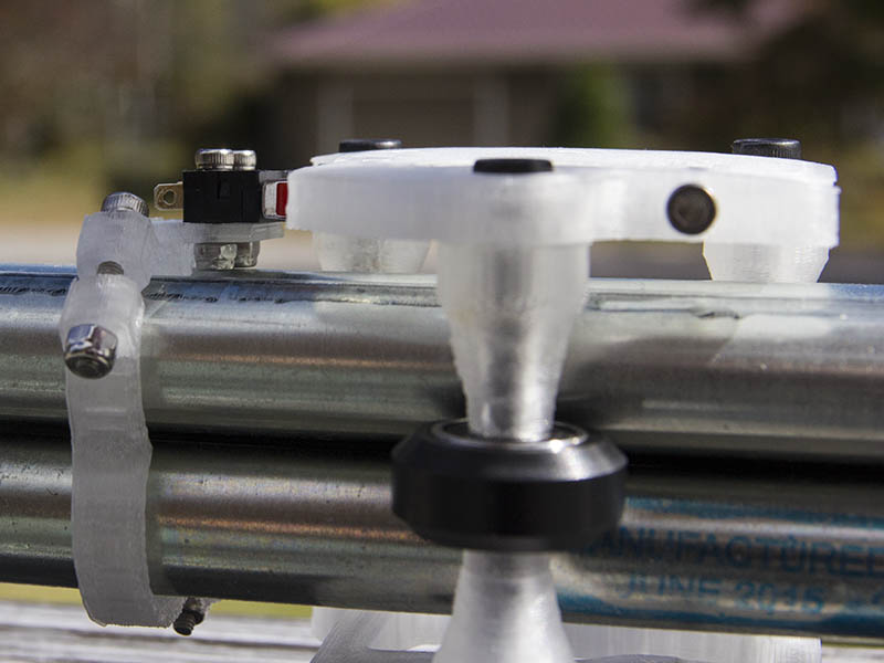

    This was my 2nd print using the switch style I mentioned. My slider is about 7mm off the face of the EMT & looks like I have room to move it at least 2mm closer to be a good connection to switch. The slider I printed is not completely flat, but works good for a test fit. Here are 3 photos of it. I am using M2.5x12mm screws & the screws are right against the EMT, so will offset the bracket another .5 to 1mm, but I am happy with how well it works. Only 1 of the locknuts touches the EMT, but have room to shift the switch 1 or 2mm to miss it. I used the 2 part bracket.

    Looks pretty good, I'm using the micro-switch variant that lacks the little roller, so I'll probably end up with the switch bumping on one of the shoulders, but that's fine, I tend to use the software offsets when calibrating anyways. I'm planning to use the two part bracket as well, much easier to install the end-stops after the main frame is assembled:)

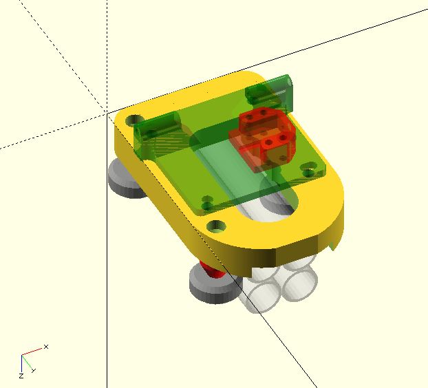

    Think I have all the parts designed for the version that uses 1/2" EMT for both the Horizontal & Verticals. This Delta Assembly is currently sized for a 300mm Build Diameter & using 1000mm length verticals. Looks like I might get about 21" build height with this configuration. Here is a screen capture of the Assembly. I am planning to mount the P/S on the side similar to the way my Folger Tech Kossel 2020 is. I added a screen capture of that bracket also. I am going to look the vertex parts over some more before printing any of those. Every time I printed them before, I found something else I wanted to change. I am going to do a test print of the P/S bracket tomorrow to make sure it seems sturdy enough.

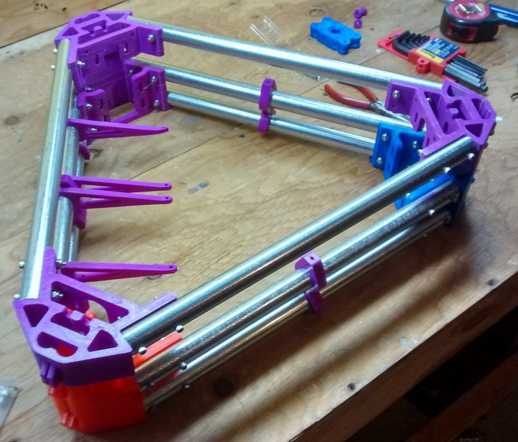

    I am finally getting into printing the vertex parts for a 1/2"EMT Horizontal & Vertical Build option. I got side tracked for a couple of weeks on upgrading my Makerfarm prusa i3v 10" to a titan extruder. That was a little pain putting together, but is working nicely.
    Below are 3 photos showing my Emmett-Delta progress. Only the green vertex part is a final print. The others are just test prints to make sure the idler bearings line up with the carriage beltway & the limit switch hits the slider. I plan on making this build using 10.5" 1/2" EMT horizontals & 31.5" (800.1mm) verticals. I should be able to use the MK3 round aluminum 220mm diameter heat bed & have a build height in the 375-400mm range.
    The vertex parts for this build only weight about 3oz. each at 50% infill with eSun PETG & take a little over 6 hours each to print. The vertex I am using for the bottom can be used for both top & bottom, but no adjustment for the belt. The top vertex has a 6mm adjustment height for the idler. Speaking of the idler, I made that idler plate a lot smaller as it did not need to be as big as I originally made it. After test fitting this, I decided to add a screw head recess for the idler plate, so I could use more standard M5x16mm screws. The idler bolt is a M5x40mm screw, but probably could use a M5x35mm.
