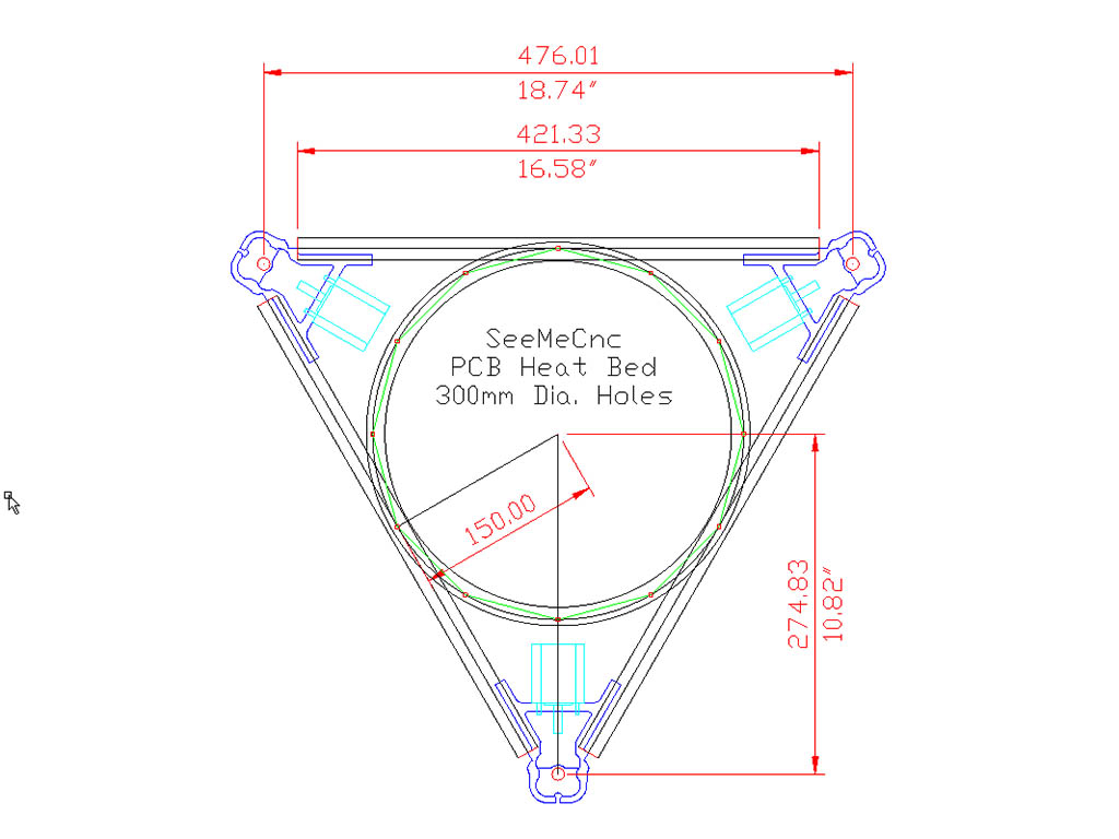

    Its looking good. You might want to test fit a slider carriage on one of the columns to see if you have any separation of the pipes where the wheels run over. At 30" height you might be ok, but Cobalt had to add some epoxy or some sort of glue to the inside of the 4 pipes to correct that. For my printing, I am using variable layer heights with the Slic3r Prusa Edition & running my Makerfarm 10" Prusa i3v at 150mm/sec using the klipper firmware. Are you familiar with the klipper firmware? Glad you were able to get the pipes in. What kind of plastic are you using? That looked like PETG in your photos.
    The effector with the bamboo looks interesting. I will be interested to see how those work. It always interesting to try new ideas.
    Is that the spreadsheet calculator you are referring to? Since you are going with 300mm build plate are you using one of the seemeCNC heatbeds? I also did an openscad calculator for this Emmett using a different configuration, but might be able to figure out what it would be for this configurarion. What is the diameter of your hole patterns for mounting your build plate?

    Here is an image showing the SeeMeCNC 300mm hole diameter heatbed & I get 16.58" for the side lengths when I drew it graphically in Draftsight. See if this looks correct. The spreadsheet showed 16.628" which is only off by 1.2mm for that distance. I will have to look back on what numbers I used with that spreadsheet.

    Yes, I used your spreadsheet. I don't have any bed (heated or otherwise) yet but 300mm was one of the defaults and seemed about as big as I can imagine needing at this point.
    Seeing that image helps a lot. My mock-up didn't have anything standing in for the build plate and I think I was visualizing less than 5" of space between tower centers and the edges of the build volume which threw off my mental proportions. I'll lay it out on the floor again (including a build-plate mock-up and see what I think).
