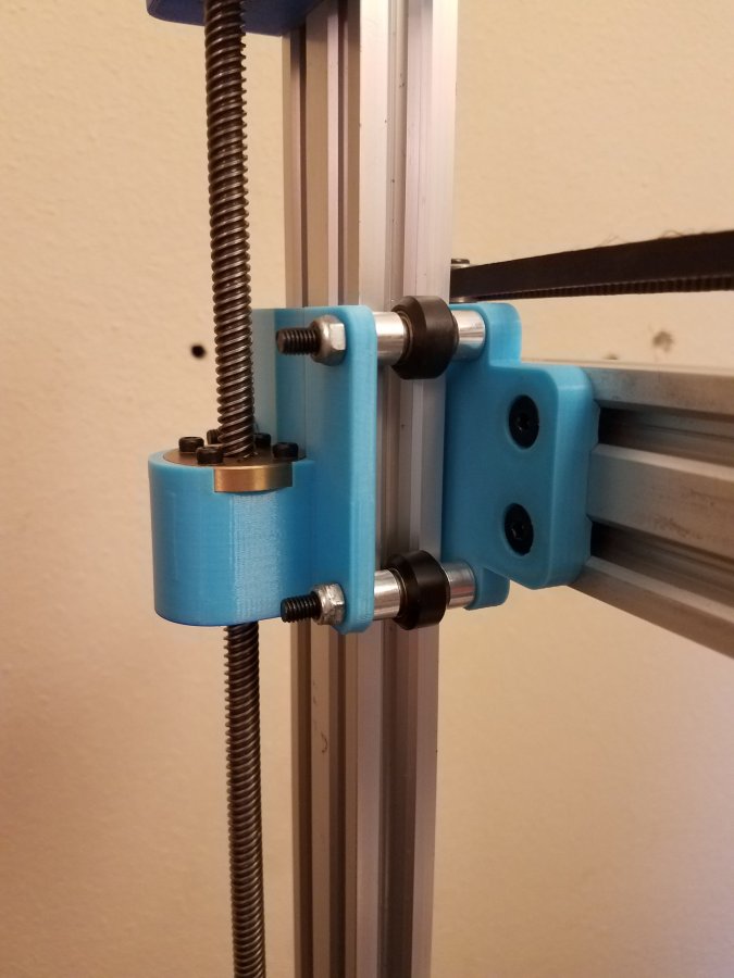

    Status Update. Got all the extrusion cut to the proper lengths and the basic frame assembled. Been spending most of the time modifying the parts for 20x40 and had to reprint some parts several times, at several hours each. Got the bed frame drilled out, after several oops (you can see them in the pictures). Because I am not planning on using the same PSU and controller as the original, the front part of my printer was too light, so I added a foot to the back part.
    Got the Z axis setup and been playing around some with it. The first belt I got was too short due to bad math on my part. New belt should be here Monday. Instead of using a belt for the Y axis, I designed a belt clamp so I can just use a length of belt. I found the Y Center piece was too long for my printer, which seemed strange since my rails are 100mm longer. I had to chop 15mm off to get it to fit. Waiting for the print to finish to know if that measurement is right. The Y Idle was sitting too high and was hitting the bed, so had to drop it some. Will adjust out the belt height once that is all finalized.

    Been playing around with the glide part of the Z axis. I'm hoping it will be easier to move once the cross piece is added. Right now it is really difficult to move. Having to reprint the two parts with the modified version for 20x40.

    In regards to the difficulty moving the Z axis, that could also be caused by the nylon nuts I am using. The ones I ordered won't be here for a couple more weeks so I printed some out of nylon.

    You should be able to turn the Z screws with your fingers. Probably fix itself with real nylon nuts. If you have an M8 tap, you could just tap out the ones you have - I sometimes have to do that if I have to hammer the nuts into the cavity.
    Suggestion: it looks like you have room left on your bed wheel screws to put a 1mm washer, or two, on the wheel side of the screw - lifting the bed by that much. It will give the idler more clearance.

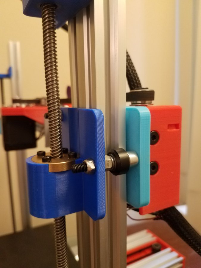

    I first want to start off saying that I really appreciate the work Keith Davis has done with his TrueUp Glide printer (TrueUp Kit Version). I had this up and printing, but was having some issues with the glide system that I was never able to resolve. When I first got it printing, I had no backlash in the X gantry when the Z axis changed direction. But after some printing and adjustments, I ended up with some backlash I just couldn't get rid of. This is more likely due to my parts than Keith's design, which I still like very much.
    To resolve this problem, I replaced the glide portion with traditional wheels. Everything else about the build remains the same. Because of this change, I am marking this build as complete and will start another build documenting the changes I have made.
    This is what I am now using.
    Changes were made to the Z mounts to accommodate the lead screw being moved to the center of the 20x40 upright. Other than these parts, everything else is the same. But because of these changes, I don't feel right calling this a TrueUp clone anymore so am marking this build as complete at this time. I'll start another build to document these modifications. Because the lead screws have been moved further apart, I had to get a new belt for the Z axis and I am waiting for it to arrive.

    I've had a couple of people buying a TrueUp kit who had the same problem with the glides. It's not actually a backlash problem. Instead, the extruder actually bobs down when the glide lifts, and bobs up when the glide goes down. The reason, the PLA inserts were not pushed down tightly in the glide cavity. The cavity and insert are tapered. Once the setscrew has cammed the insert in to seat the nylon round against the rail slot, the insert needs to be pushed down so it wedges tightly in the cavity. Even the slightest play between the insert sides and cavity front & back walls will let the glide body rock against the insert, causing the bobbing motion.
    That said, I'm developing a new version of TrueUp that does not used the glide. I'm going for mini v-wheels like you did. My problem is still not with the glide concept, which is extremely rigid when set up correctly (I carry my printer around by the X rail). The problem is in marketing. The self-leveling single Z motor is the main selling point of a TrueUp. Having to explain, and sell, the glide concept also just distracts from the leveling concept, making the "sale point" confusing. Using wheels adds about $40 to construction, which is really why I developed the glide, but I think being able to focus on the main feature will not hurt sales with the additional price.
