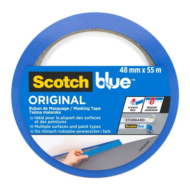

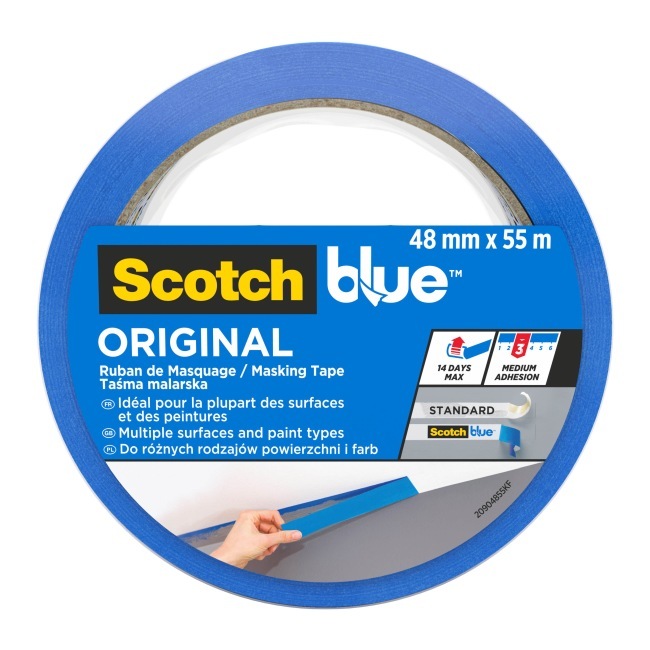

    This tape will be ok?
  7. Alex Chambers
    2,774
    1,358
    Yes - that should be fine.
