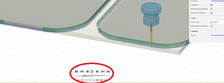

    Hi everybody, I (not frequently) use Fusion to apply CAM.
    I have a problem with contour 2d:
    I use a 6 mm end mill on my workbee 1510.
    I select in Fusion the bottom contour of the model adding tabs and multiple depths of 3mm.
    When I simulate the path, it goes backward!
    It starts from the bottom and goes up to the top...whyyyyyyyy? i'm getting crazy.
    I here add some screen shots:
    thank you for your time and help.
    Macs

    The screen shots are too low resolution to be able to read. Can you post the F360 file (*.f3d) and I will take a look.

    Ha ha! That was easier than I thought - I didn't really need the file:
    You have the simulation running backwards! :D
    You see the dot on the slider under the 'play' controls? Drag that to the right of centre and it will run forwards again. :)
    (For what it is worth, the simulation ran OK for me.)

    I want to cry and laugh at the same time
    thank you so much Misterg!
