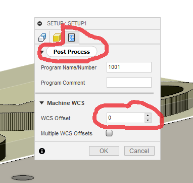

    hi Guys why am i getting this error when trying to save gcode? if i use normal GRBL post-processor works fine
  8. Alex Chambers
    2,834
    1,393
    It's just telling you that, in setup, you didn't specify which wcs to use, so it's going to use the default of wcs1 (G54).
  9. dfox1787
    dfox1787 New
    Nov 2, 2019
    42
    so i can ignore it? i dont want to add any offsets to my wcs i want it to start where i selected
  10. Alex Chambers
    2,834
    1,393
    It uses the word offset because every wcs is an offset from the machine co-ordinate system. You won't be changing where your job starts. You can ignore it if you want, or change that "wcs offset" box to 1 and the message will go away.

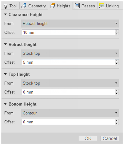

    Hello every one, i have been trying to post process à plasma cut following using the openbuild post processor and every time the gcode generation fail.
    i have this message in the log:
    (Made in : Autodesk CAM Post Processor)
    (G-Code optimized for Grbl 1.1 / BlackBox controller)
    (OpenBuilds CNC : GRBL/BlackBox)
    (Post-Processor : OpenbuildsFusion360PostGrbl.cps V1.0.37)
    (Units = mm)

    G90 G94 G17
    G21
    !Error: Failed to post data. See log for details.
    Erreur: TOP HEIGHT MUST BE BELOW PLASMA PIERCE HEIGHT (links tab)
    Error at line: 880
    Error in operation: 'Profil 2D5'
    Failed while processing onSection() for record 279.
    Erreur: Failed to invoke function 'onSection'.
    Erreur: Failed to invoke 'onSection' in the post configuration.
    Erreur: Failed to execute configuration.
    Stop time: Sun Dec 10 20:51:58 2023
    Post processing failed.
    thank you!

    teurlai New
    May 1, 2023
    Thank you peter for the quick answer,
    Do you know where i set up the top height? I searched in the tool configuration but cannot find it....newbie....
  25. Peter Van Der Walt
    Builder Resident Builder
    15,699
    4,510
    fusion360 "top height" - Google Search
    teurlai likes this.

    OK, updated computer/software/fusion.. blah blah blah.. everything good except I could swear it used to auto set the WCS offset to "1" auto before, which I remember having to do at least, but now it doesn't.. and I can't remember how to and searching I didn't find here.. guess I'm searching with wrong keywords? or is in not working anymore? what stupid thing am I missing?
    thanks!
  28. Misterg
    Misterg Veteran
    Aug 27, 2022
    429
    332
    A fairly recent update to Fusion changed a lot of the manufacturing settings, and as a result, some defaults got lost - might be the case here.
    Anyway:
    In Fusion, Manufacturing:
    On the Post Processing tab of the Setup, Enter '1' in the WCS, right click, and save as your preferred default:
    Thomllama likes this.
