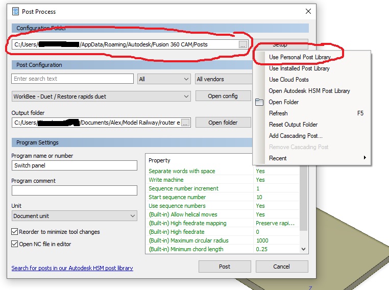

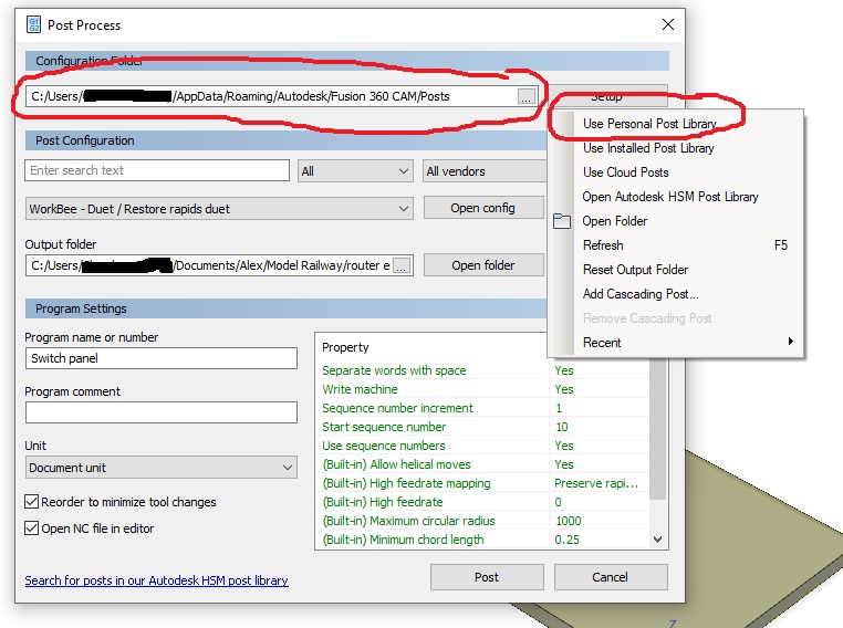

  7. Alex Chambers
    2,779
    1,359
    See the pic below - when you have downloaded the Openbuilds post processor, copy it into the directory shown, and select "Use Personal Post Library"

  11. David the swarfer
    3,438
    1,908
    put the post file in any folder you like, say c:\users\yourname\documents
    click little square with the ... in it rather than open the menu
    open your documents folder
    click 'ok'
    now, the available posts will be listed and you can select the post file, (I have a few, you will have only the one you downloaded, see my video later.)
    This selection will remain selected unless you change it. You may need to reselect for each new drawing, but I doubt it.

  12. David the swarfer
    3,438
    1,908
    In essence, you put the post file somewhere, then you tell Fusion where it is.
    The somewhere can be one of fusions defined and preferred places like the 'personal post library' folder indicated previously, or it can be ANY folder that you know how to find, Desktop, My Documents, Downloads, some mapped network drive if you have a server, etc etc.
    Here is how, watch the video

  16. sharmstr
    2,059
    1,448
    Looks like you got to that screen via the setup menu. That's why the screen looks different. Go to the Actions menu and click on Post Process

  23. Rob Taylor
    Rob Taylor Master
    Dec 15, 2013
    1,470
    748
    Ok I haven't really been following the thread, but if all you're trying to do is install a custom post, wouldn't one of these three buttons allow you to find it in the folder you downloaded it to?
    Seems like it to me, anyway. I'm assuming the dots would be the one- dropdown allows selection of stuff it knows is there, pencil is edit what you currently have selected.
    Again, I haven't looked into it at all, just... That's how computer UIs are supposed to work.
    Also, the original screens that Alex showed you-
    - are literally from when you've finished your CAM and hit "Post-Process". It's like, the final step. You can't do it without actually having at least one operation in your setup.
