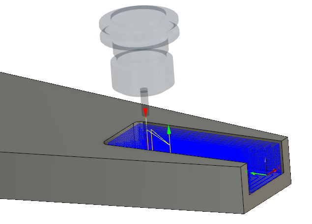

    Evening All.... sad news.. whilst the tool path seems correct on the X and Y, the Z axis is not moving. When the job starts the Z axis stays int eh home position... has anyone seen such behaviour before?

    Is the Z axis still alive (can you jog it?)

    yes it moves when i move the machine around..

  7. Colin Hart
    Colin Hart Well-Known
    Feb 9, 2019
    68
    29
    Hi @Alex Chambers - whats the malt? I about to embark on a little sailing trip around the Scottish isles for some whiskey collecting...
    Cheers for offering to take a look, I've uploaded the gcode as a file, below of a screenshot of the fusion. can share the model if you have an account...

  12. David the swarfer
    3,604
    1,978
    I seem to recall a lower speed limit in GRBL and I see that your plunge feedrate is only 30mm/minute which is very slow... ah yes, google says...
    0.9i - Min feedrate appears to be around 40-45mm/min · Issue #742 · grbl/grbl
    says 40 to 45mm/min and yours is set even lower.
    Given that your other rates are much faster, maybe what you meant was 300mm/min plunge rate?

  14. Alex Chambers
    2,834
    1,392
    Hi @Colin Hart, check your retract heights - are you hitting the Z axis limit switch as your machine moves into position? This seems to be what happened on my machine when I tried your G code - first run - no movement on Z axis. second run - lowered Z 10 mm and reset WCS zero - Z behaved as expected.

  16. Colin Hart
    Feb 9, 2019
    68
    29
    Hi @Alex Chambers. Sorry today was supposed to be an easy day, instead, I have just managed to catch up on posts....so I can share my Fusion design with you, I need your email address, then I can add your account to my project.
    my bit is a 6mm flat end mill, i did think 1mm was conservative however, didn't was to overcook it, the wood is fair hard.
    In fusion to the stock is set with 0 offset on the top, so it should drop to the top of the WCS.
  17. Alex Chambers
    2,834
    1,392
    Hi @Colin Hart, height is definitely the problem here - according to Ooznest;
    Z Height
    54mm Or 94mm Travel, 27mm Or 47mm Workable depth, with a 12mm spoilerboard. The spoilerboard supports have two height configurations, these are the maximums for each configuration.
    You have a stock piece 40mm thick with a top offset of 12mm - total 52mm. Your pocket toolpath starts 10mm above the stock, so your hitting the Z axis limit switch before the machine gets to the right height to start.
    I would suggest reducing the top offset, but if you can get this confirmed by someone who knows more about Fusion 360 than I do that would be a good idea. Why did you set the stock top offset to 12mm?
