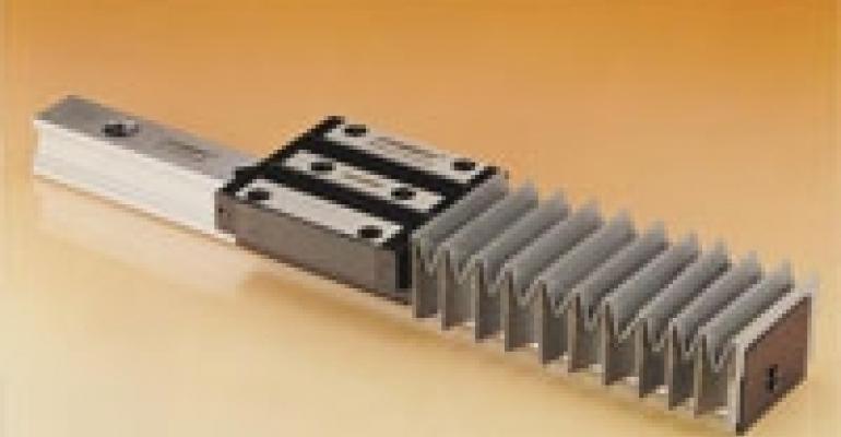

    Yeah this is definitely a concern. I have actually seen bellows designed for linear rails or I could install shielding. The linear carriages do have rubber wipers but I don't want to chew those up.
  10. Michael.M
    Michael.M Veteran
    Jan 21, 2017
    432
    268
    I'm sure these aren't cheap though

    They're heavy duty but you still want to avoid contamination. Chips could cause the bearing balls to jam up and stop circulating which would be very bad.

    Finding bellows is difficult, I've been looking for solutions for both the linear rails and the ballscrews.

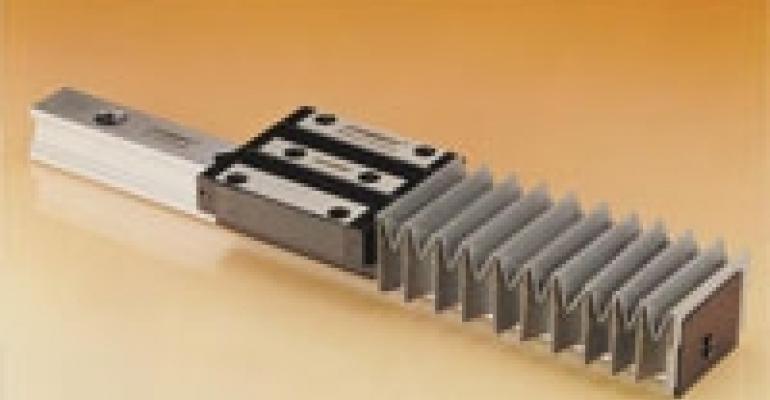

  16. Andreas Bockert
    Andreas Bockert Well-Known
    Oct 1, 2017
    142
    78
  17. Michael.M
    Michael.M Veteran
    Jan 21, 2017
    432
    268
    Maybe they're just showing different models. It looks like they can do custom orders.

    BTW if you guys are looking to custom make some billows check this bellows maker resource out.
    Michael.M and joe williams like this.
  19. GrayUK
    They don't look bad at all! :D
  20. Michael.M
    Michael.M Veteran
    Jan 21, 2017
    432
    268
    Oh that's awesome! I was wondering if this could be done. Thank you Mark.
