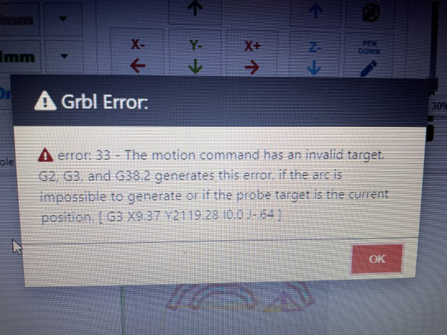

    The motion command has an invalid target. G2, G3, and G38.2 generates this error...
    I've come to the conclusion that NX and/or the postprocessor is not producing enough accuracy to satisfy the (IMO) overly strict limits of GRBL.
    Three solutions that I can think of:
    1. Relax GRBL accuracy limits. Is this possible? I really only need total machine accuracy of about 0.5mm.
    2. Increase accuracy in gcode.
    3. Switch from I,J to R. (But I've had issues with R in the past).
    The Gcode that triggers the above error:
    G0 X548.5700 Y1298.5600
    M3 S217 ; pen down
    G4 P0.25 ; wait for pen to lower
    G1
    G2 X546.3200 Y1299.8500 I-1.5000 J.0000
    < ERROR
    X548.5700 Y1298.5600 I.7500 J-1.2900
    M3 S10 ; pen up
    G4 P0.25 ; wait for pen to raise
    If I throw the above Gcode into CAD, there is an error of about 0.0078mm:
    I've tried to increase the significant digits and accuracy in NX and post builder, but apparently I can't figure out where to do it.
    From NX>Manufacture: If I choose List Tool Path, this has higher precision. Here is the code (corresponding to the Gcode above):

    So there appears to be loss of precision in the post builder maybe? Anyone have any ideas how to improve precision?

    I've found out how to increase precision in NX post builder. It's on the first page:
    I changed Linear Motion Resolution from 0.01 to 0.001, and was able to run the job without errors.
    <Beer emoji>
  3. David the swarfer
    3,490
    1,927
    in your image the arc has a radius of 0.64mm.
    As the radius decreases, the limits of accuracy of the endpoints approach rapidly.
    The best fix is to change the post to linearize arcs with radius less than bitRadius.
    Yes, this is common, battled it in Fusion360 as well. Essentially, ALL arcs have errors, but the percentage error for small radii triggers GRBL's error message.
    Solution: avoid small arcs (-:
