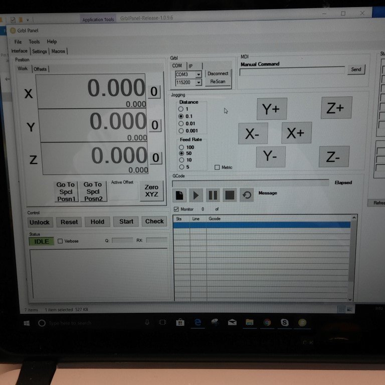

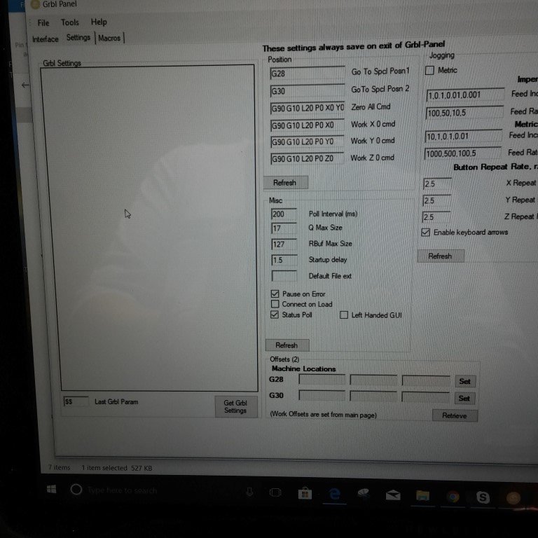

  17. blindflight
    blindflight Well-Known
    Sep 19, 2013
    53
    56
    Afternoon Phil,
    Here is the photo I should have included. Nothing is loaded in the settings like before . see pics. I get the Grbl settings run thru the window knowing its loaded. I can jog..Seems the settings are gone.

  18. NeoMorph
    NeoMorph New
    Jul 1, 2017
    68
    20
    Have you tried other GRBL control Programs... like Universal G-code Sender? That would be my next step. Whenever I have a problem like this I try alternatives to see if it flags up problems. I had a flipped limit switch which has going high when active instead of low (due to mixing micro switches with proximity ones). Couldn’t figure it out until I used UGS to confirm what was happening. It could be something as silly as a corrupted setting in GRBL Panel and using UGS would sort it out.
    Oh... come to think of it, I had a problem where some of my settings vanished as well (lost setting $100 and higher)... turned out I was using the wrong grbl source code and none of my limits were showing up in G Panel. Not helpful in your case but it shows how there are numerous failure points that can be caused by corrupted settings. Just got to change one thing at a time.
    So yeah... load up UGS (the latest version, not an old one like I did and then wondered why it wasn’t working) and see if you can get your board to pop out the settings.
