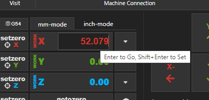

    Hello, is there a grbl program that will tell me how to calibrate my x axis or 4th axis. I am using a 100:1 drive. Maybe something that generates x steps and I look at a mark on the chuck, keep changing the steps until I get a full turn
    Thanks John
  6. David the swarfer
    3,604
    1,978
    there is this for linear axes
    GRBL settings calculator
    the math is not difficult and is explained in several places on these forums. (though not directly for rotary wrapping)
    C-Beam™ Machine - Plate Maker
    the theory says that you can start with a completely unknown system and calibrate it, ie no idea about gearbox ratio, motor steps, microstepping or anything else, just set some defaults and try and correct using the formulas in the link above. The difficulty would be in accurately determining a full rotation
    however, this system is not unknown, making it easier.
    200 step per rev motor
    8x microstepping (default in Blackbox)
    = 1600 steps per rev of the motor
    * 100 gearbox ratio
    = 160 000 steps per rev on the 4th axis
    but GRBL needs steps/mm which would apply at the circumference of the part you are machining for a wrapped toolpath.
    steps/mm = stepsperrev / circumference
    or
    steps/mm = 160000 / (pi * diameter) (in millimeters)
    or
    steps/mm = 50929.58 / diameter
    you can stickynote that number to your PC so you can reset steps/mm for each job easily, keep a 50 cent pocket calculator handy for the job.

    Start with calculating the theoretical numbers
    Motor, probably 200 steps per rotation
    BlackBox = 1/8th microstepping. 8*200 = 1600 steps per rotation of the motor
    Count the pulley teeth and calculate the gear ratios (count and post here if you need help) and multiply with the 1600. Will tell you exactly how many steps per rotation then divide by 360 = steps per degree
    Setup your controller with the theoretical values before you try to test

    The chuck is 100:1, no pully, so we get 160,000 and then divide by 360 we get 444.44. So given that number I would want to check to see if it is correct using the GRBL program. Do you think the program makes sense?
    John
  14. Peter Van Der Walt
    Builder Resident Builder
    15,699
    4,510
    You could, I would just use the jog buttons. Set zero and then jog 3x100s + 6x 10s (DRO will show 360) - did it do 360deg?
    (Or type 360 and then enter in DRO, instead of multiple jog button clicks, but buttons might be easier)
  15. Peter Van Der Walt
    15,699
    4,510
    try theoretical number first, if still stuck post a Grbl Settings backup for review

    Hi in setting my rotary steps/mm, my chuck is 319.18 mm circumference. I took a guess and set the steps/mm in the profile to 500, set the x axis which drives my rotary to 0.0 mm. I put a tape mark on the chuck and ran the chuck 360 deg that is from tape mark to tape mark. The readout was 319.149. I think that was a fantastic first guess and a keeper.
    In a different subject I tried to update control to the new version and it updated to the same version xx.371. Upon further inspection it might be the first line, top line, that hasn’t changed from 371.
    I will go to gadget now a see if I can create a rounding tool path.
    thanks for your help
  22. Peter Van Der Walt
    15,699
    4,510
    371 is the latest. The older version was 370 - back in June 2023 from which you should update to 1.0.371
    Releases · OpenBuilds/OpenBuilds-CONTROL
    I am working toward V1.0.372 - pushing code to a draft already - but its not released, couple more tickets to close first
    OpenBuilds-CONTROL/CHANGELOG.txt at master · OpenBuilds/OpenBuilds-CONTROL
    Well, not a keeper, still far off
    But. 319.149 / 360 = 0.886525 * 500 = 443.2625
    Making my earlier calculation:
    which gave you
    probably the proper Keeper (;
    Change the 500 to 444.44
