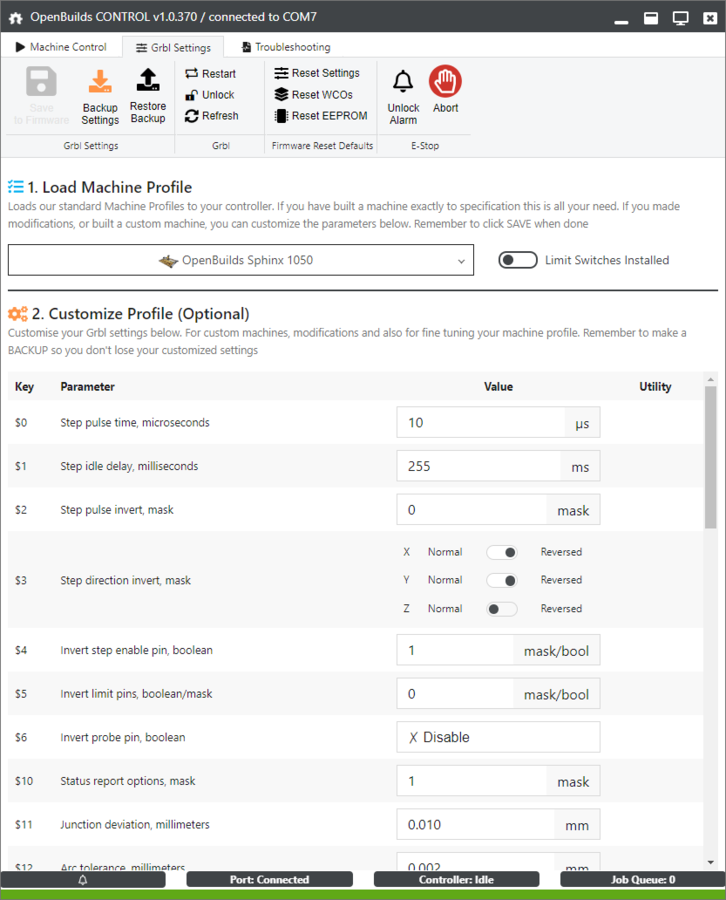

    @Peter Van Der Walt I finally got my head around grblHAL - although I did end up needing "Config App" from ioSender to configure it as OB Control isn't fully aware of it it and thinks it's regular grbl.
    GRBL_SPD works very well in grblHAL with the following config:
    Code:
    $30=30000.000  ;  Maximum spindle speed, RPM
    $31=10000.000  ;  Minimum spindle speed, RPM
    $32=0  ;  Laser-mode enable, boolean
    $33=1000.0  ;  Spindle PWM frequency
    $34=0.0  ;  Spindle off Value
    $35=2.0  ;  Spindle min value
    $36=100.0  ;  Spindle max value

  10. David the swarfer
    3,604
    1,978
    um, nothing hard about this GRBL settings tab in OB CONTROL (-:
    dJOS_500 likes this.
  11. dJOS_500
    dJOS_500 Journeyman
    Jul 16, 2022
    322
    131
    Hmm, maybe it’s dark mode making it hard for me. The rest of the UI is great, but I found the settings page less clear. Settings are too spread out and not grouped logically.
    This is config app - it’s logically laid out and has generally great explanations of the settings. It’s not pretty, but it’s actually easier to use.
