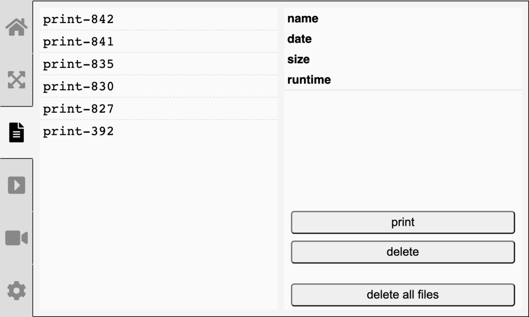

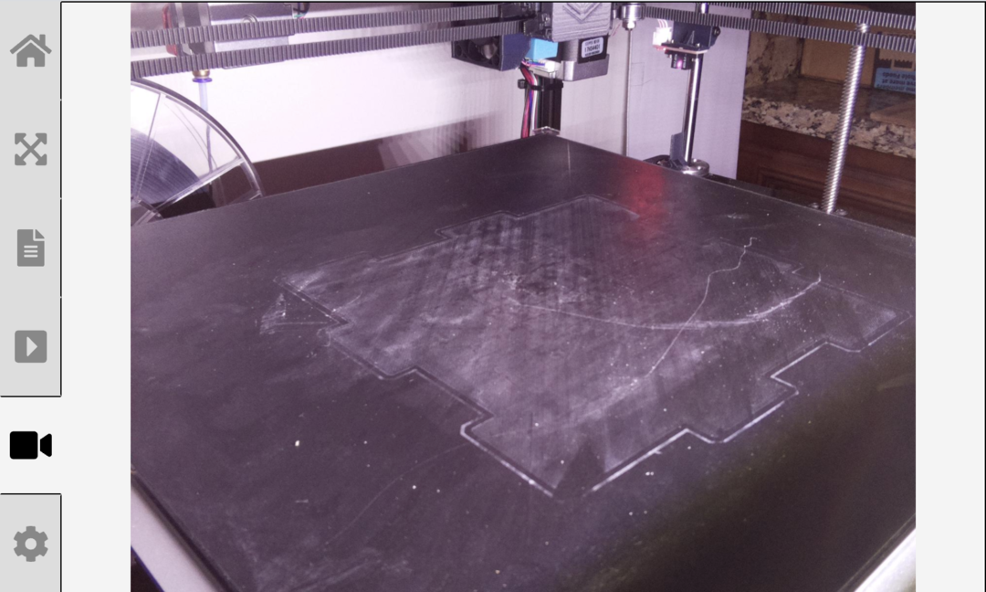

    Thank you so much!!! That worked. I have 2 more questions, sorry, i know that is a lot, but i’m really a starter in this world...
    1) how do i visualize the câmera on web surface?
    2) How do i upload a archive to the machine physically? Via pendrive on raspberry?
  8. SOA
    SOA Well-Known
    Jan 22, 2020
    39
    54
    1. there should be a camera tab. it shows whatever is on a raspberry cam. if you have a usb cam, we need to discuss.
    2. drag/drop files onto the file list on the file tab. or, if you use Kiri:Moto, enable GridLocal under preferences and the printer will show up automatically on print export.
