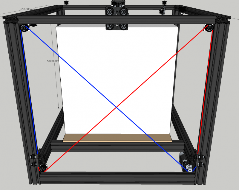

  13. Giuliano M
    Giuliano M Well-Known
    Apr 3, 2014
    193
    39
    I'm not sure if I've seen your mini v-slot gantry plate - if it's not in this thread, a link would be appreciated. Or if it is, a post number. :)
    I'm not 100% set on the Replicape hardware yet, as their initial release was a bit expensive - and the less expensive revision "B" boards are supposedly in progress.
    The Replicape Redeem software does seem to be the limiting factor right now - though I've been monitoring their Bitbucket repo, and there's been lots of recent activity, so maybe that will improve.
    The CRAMPS board does look interesting - I like the support for LinuxCNC, so I may have to take a look at it.
    I'm assuming that the CRAMPS can use the DRV8255 pololu shields.
    I haven't been able to do much work on this project recently, as the tax man has called and I'll be in a hole for a few months...

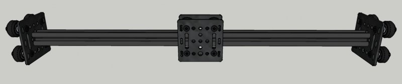

  16. Giuliano M
    Apr 3, 2014
    193
    39
    So, this is an alternate carriage that I've mocked up, using the newer 20mm gantry plates - thanks to TomH for the idea. :)
    Needs some work to be done to integrate the idler pulleys at each end, but it has some potential.
    Vertical X-carriage plate, mounting surface area on the front and back, with the slots for belts offset by the standard 20mm spacing...
    I'm thinking that the single 20mm v-slot bar could spin/twist on the central screw hole, but some brackets should take care of that.
  17. TomH
    TomH Well-Known
    Mar 10, 2015
    108
    In your last gantry depiction (in post 9445) your side rails were vertical whereas this H bar rail appears to require horizontal side rails or 20x20's to ride on. Did you change your gantry side rails as well?
  18. Giuliano M
    Apr 3, 2014
    193
    39
    Yeah, I plan to turn the side rails onto the horizontal orientation, just haven't modeled that part yet.

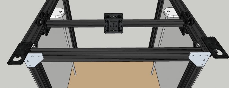

  19. Giuliano M
    Apr 3, 2014
    193
    39
    The new gantry and side rails are more likely to be like this.
    The side rails are rotated horizontally, with the gantry wheels riding along the inner track.
    I'm modeling this with the OpenBuilds Nema17 mounting plates for the X/Y motors in the front - the plate on the right will be raised up by 20mm with a spacer block of some kind, possibly printed.
  20. TomH
    TomH Well-Known
    Mar 10, 2015
    108
    Your belt routing seems problematic in this configuration. Didn't your printed stepper mounts work as is? Couldn't you do the same thing by mounting the single 20x20 gantry rail like you did previously and modify your pulley mounts while utilizing your originally printed stepper mounts? A single pulley mount could then be used to hold both front and rear pulleys and you wouldn't need to cut the gantry rail.
  21. Giuliano M
    Apr 3, 2014
    193
    39
    Yeah, I realized that after I started lining things up.
    The alternative I'm going with now is with the top beams laid flat in a square, with the X/Y motors mounted off of the front bar - one motor face up, one motor face down.
    The two belt paths won't intersect - one on top of the bars, one below the bars, and they should line up with the belt slots in the gantry plate.
    Had to move the Z motor assemblies to the outside of the frame, too... I'm sure that will bring further changes down the road.
    I really like the new smaller gantry plate concept - the universal one is just too big without having to hack it down to size.
    Also, all of the v-slot stock I got was in 1500mm lengths, so I'm not too worried about cutting the rest down to odd sizes.
    I may try to accommodate a 20x20 gantry rail as-is at 500mm long, but of course that pushes everything else around it to longer lengths...

  26. TomH
    TomH Well-Known
    Mar 10, 2015
    108
    Let me know your thoughts about the CRAMPS after you fire it up with a BBB and check it out... I'm now waiting for the arrival of my BBP 1S:

  27. Giuliano M
    Apr 3, 2014
    193
    39
    New plan: Architect the frame for the build volume I want (400mx3) rather than arbitrary 500mm V-Slot lengths.
    This required that I make things.... bigger.
    New plan makes the frame wider and deeper, to allow both sides of the print head carriage to reach all 400mm cubed space - which is what the white box is - 400x400x400mm. Still re-working the Z-plate assembly to the larger frame...
    You can't see it from this angle, but there's a second E3D Cyclops/Chimera block on the other side of the carriage.
    The V-Slot I have is in 1000mm lengths, so I'll have to order some more... I'm sure I'll be able to re-use the cut-offs. :)

  30. Giuliano M
    Apr 3, 2014
    193
    39
    I've read of others using belt systems for Z axis without issues, even reports of it eliminating Z-banding.
    I think I'll go with this arrangement instead - 8mm drill rod shafts at the top and bottom with toothed pulleys, with a short closed-loop belt being driven by the stepper motor underneath.
    Duplicated on the other side to lift the other end of the plate..
